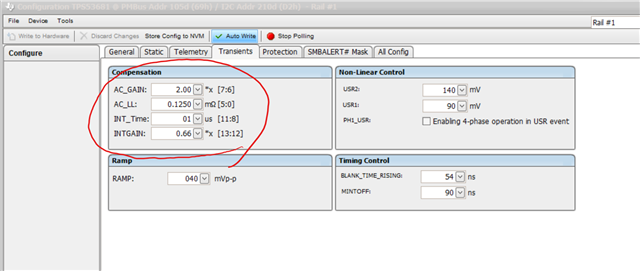

I design power supply system(TPS53681 & CSD95490Q5MC) for FPGA(XCZU67DR).
I am using Fution digital power designer.
But I don't know how to adjust compensation parameter.
How can I adjustment these parameter?
  • Hi Kenji Shimada,
    These are the control loop parameters (in simple terms proportional and integrator gains). These depend on what your system requirements are.
    In order to help you tune these parameters, I need to know your system requirements like number of phases of operation, output voltage, switching frequency, inductor value and output capacitor value.
    Thank you,
    Ashwin K

  • Now I can't start up power supply rail#1 & rail#2.
    So please teach me the trouble cause.
    I send problem_issue.pdf & parameter.xml file
    TPS53681 @ PMBus Address 105d Project_050317b.xml
     I attached problem_issue.pdf

  • I think this problem is caused by VOUT starting up in a staircase pattern as shown in the figure below. What do you think?
  • Hi Kenji Shimada,

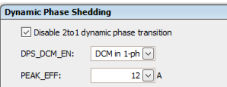

    After looking at the waveforms I suspect the following:
    1. For Rail 1, it is clearly a case of DCM operation. In your config file, you can change the DCM configuration to CCM in 1-Ph. 'Store to NVM' and repeat the experiment.
    2. For rail 2, it looks like loop instability issue. You have to tune the loop parameters based on the compensation parameters. Right now it looks like all your parameters are high which makes the loop bandwidth very high and phase margin very less because of which you see a lot of ringing in the system.
    Following are the steps you can follow to tune the loop:
    a. As a starting point, you can keep ACLL as 0.5mohm, INT_TIME as 5us and AC GAIN as 0.5 to start with and try wake up.
    b. In order to increase bandwidth (make loop faster but start seeing some oscillations at higher bnadwidth) - increase AC GAIN or decrease ACLL or decrease INT_TIME or increase INT_GAIN.
    c. Vary these parameters individually first to set to your desired point.
    Please let me know of the results.
