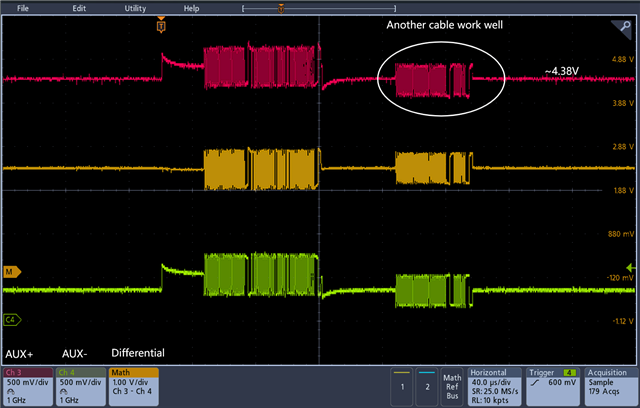

TUSB546A-DCI: DP AUX signal only have negative portion after TUSB546A
Hi Team,

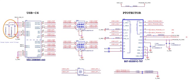

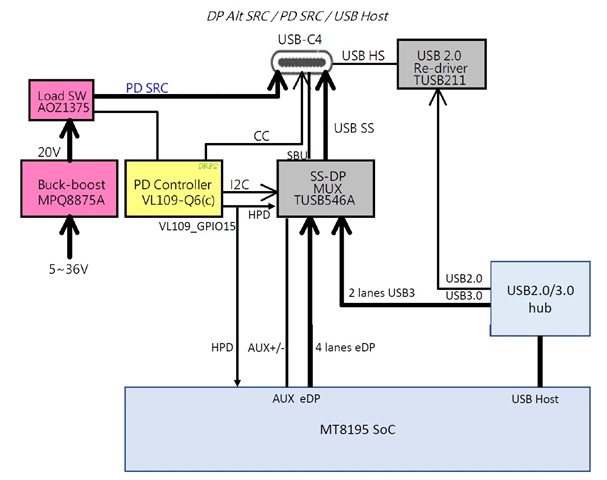

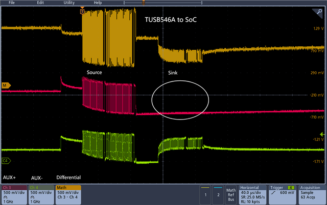

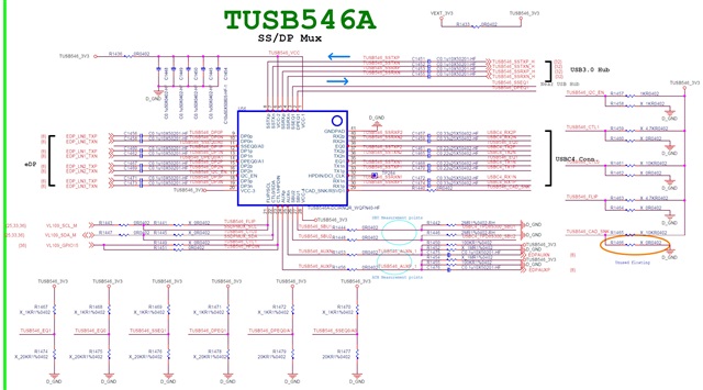

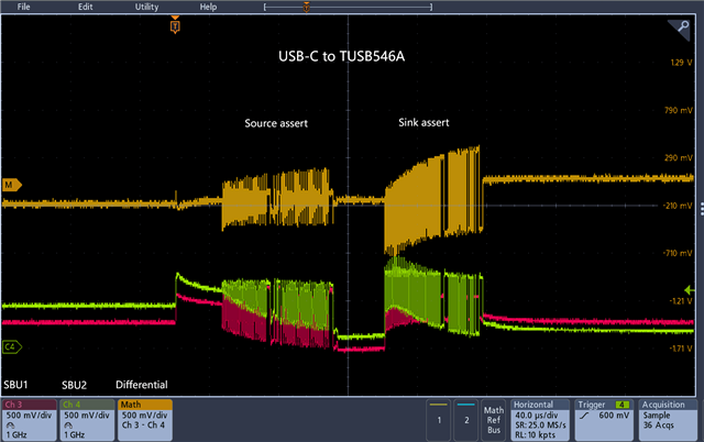

Our design uses TUSB546A for USB-C DP Alt source function. We encounter a DP no display problem. After trace SBU and AUX signal from USB-C to TUSB546A, I found Source side output AUX/SBU to sink but sink replied signal AUX+ disappeared. Schematics and waveform as followed.
USB-C4-DP.pdf
