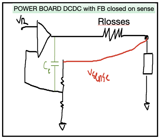

Hi
We are trying to see if it is possible to close the loop of the DCDC using a remote sense. Please see simplified figure 1 attached
The Rlosses + Rsense is in reality a complex impedance. Hence the whole feedback system will look like figure 2
The realistic model for the load will be like picture 3
We did AC analysis of our fb network compared to that of the ideal case ( ie without the Z(w) of picture 3). It seems like if Cc>100pF, the effect of Z(w) is negligible since it gets bypassed by the Cap. See picture 4
However, I downloaded the PSPICE model of the DCDC from the TI website and ran transient simulation where after the DCDC is up I applied load step currents ( by closing switches with 2Ω loads). As can be seen in figure 5, for the second step the the DCDC has a strange behavior. I have tried tightening simulation tolerances etc but this behavior happens sometimes. Doing a sweep of CC it happens for some cases but not for others etc (ie might happen at 4nF but not at 1nF etc).
Can you help telling us how to proceed? we would really like to close the loop after the looses since otherwise we have excessive IR drop at the pin of the chip

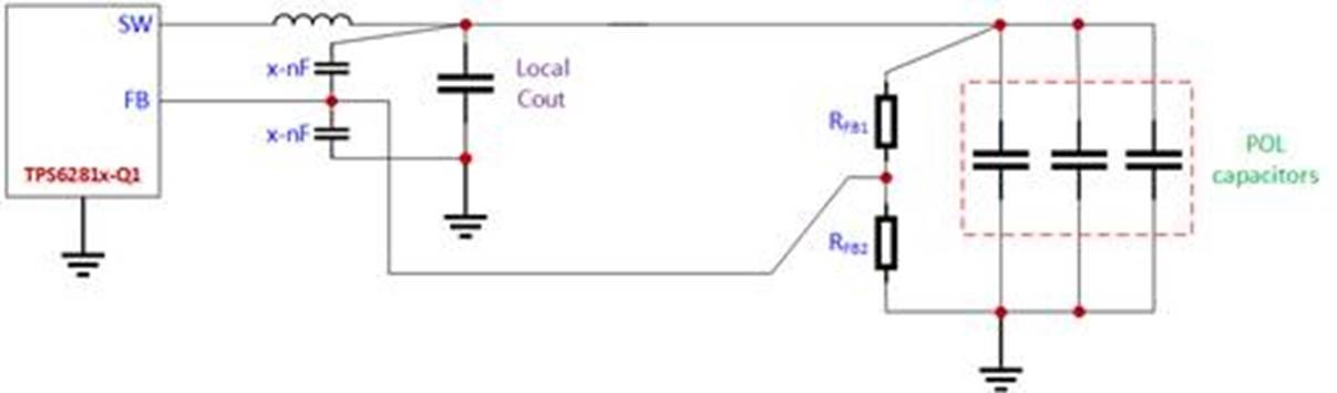

  • Hello Juan,
    TPS62A01-Q1 is not meant for remote sensing as it does not have VOS or dedicated AGND pin. That is why it is not possible to use differential feedback voltage sensing.
    One option will be to use something like below: capacitor divider helps to reduce noise and stabilize the senses voltage while resistor divider to scale the volatge.
    My second question is you write Cc=200pF and 1nF. What is that? Is it feedforward capacitor?
    Also which model you are using? Can you share the source please?

  • Hi Farheen
    Picture below is what we are trying to do with Cc highlighted

  • also we are just trying to compensate for the IR drops on the supply, not supply and gnd since as you mention this part doesn't offer differential remote sensing

  • Hello ,
    We do not recommend using values above the mentioned values in D/S as device is validated only with that. It can affect the stability performance.
    R values, you can choose according to resister divider equation: Vout=(1+R1/R2)x0.6
    Capacitors values should be in pF range. As a start you can run simulations from 100pF to 1nF and C2 10pF to 100pF. You need to run the stability simulation also to check that loop is stable and this device does not have average model for AC response simulations.
    I will recommend device like TPS62810-Q1 or TPS628502-Q1.
    Coming to first thing why Vout is dropping, have you simulated inductor current and switching frequency? Looks like device is starting again..
