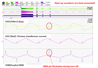

My customer is currently designing an LLC converter using the UCC256601, and I would like to consult with you regarding an issue related to the behavior of the ISNS pin.
Issue Description:
  • The ISNS pin voltage exceeds the OCP threshold, triggering OCP.
  • The startup waveform is shown below. The ISNS terminal rating has been exceeded, causing the device to shut down due to OCP.

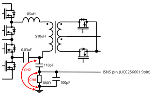

The differentiator circuit for ISNS is currently configured as follows:
Questions:
  1. The datasheet specifies CISNS = 150pF. Are there any potential issues with the placement or capacitance of the capacitors in the circuit above?
  2. We observed fluctuations in the ISNS signal during turn-off. Would adjusting RISNS (e.g., increasing from 180Ω to 200Ω or 220Ω) be an effective way to suppress this fluctuation? Alternatively, should we consider adding a ferrite bead to the ISNS line for noise filtering?

  • Hi Conor,
    Looks like controller is operating is operating in the burst mode. Do you see controller is restarting every 1sec? Its not clear from the waveform.
    Please confirm.

    As you mentioned, given that this is a no-load condition, it is highly likely that the controller has entered "burst mode". Since burst mode involves alternating ON and OFF switching periods, is there a possibility that the ISNS pin experiences significant intermittent fluctuations (spikes or noise)?  I would also like to confirm whether the current ISNS peripheral circuit (RC values, etc.) is correctly configured.
    Specifically, I would appreciate your comments on the following:
    ・Are the recommended CISNS and RISNS values appropriate?
    ・Is the placement of the filtering capacitor(110pF) correct?

  • Hi Conor,
    I have responded to the customer issue in different thread. Looks like, the \wrong connections are done in the schematic. Please see my comments:
    (3) UCC25660: ISNS has an indefinite value when turned on - Power management forum - Power management - TI E2E support forums
