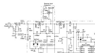

Following up on a closed thread regarding the issue. What can be done to make the IC withstand reverse polarity events?

  • I think I also need to protect ACDRV pin, as the first mosfet would allow current to flow in that direction.
  • The Zener/TVS diode should block the negative voltage back feeding to ACDRV pin, but I am worried that the capacitor between Gate and Source might provide a path for the negative voltage during a transient event and damage the input with the short negative pulse.

    That is a concern.  I found a reverse polarity protection circuit for input voltage for an older device in https://www.ti.com/lit/ug/sluu462a/sluu462a.pdf.  It doesn't protect the VACx lines however.
    Jeff
  • Jeff, sorry for the lack of expertise/understanding, but simulating the circuit in spice did not yield any protection, i am not clear on how it works.
    Regards, Ivan.
  • HI Ivan,
    With reverse input, I think Q1 turns on, shorting Q2 and Q3 gate to sources (and IC CMSRC to ACDRV).  Any reverse current flows through this FET and Q1 diode. This circuit may not work with BQ25798 because it does not have the CMSRC pin and has the VACx pins instead.
    Jeff
