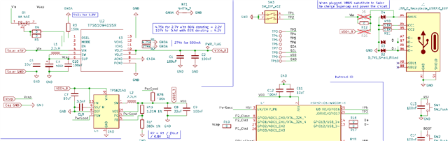

I've a TPS61094 that's used for the main energy manager of a board. In this case, Vin comes from USB (typically 5V) or (exclusive) a solar panel, and the Vout is set to 4.8V. It's set in all automatic mode (EN = MODE = 1) with automatic switch to Vcap when Vin disappear.
The circuit works fine both when Vin is present (correct output, no ripple, the second stage outputs 3.3V for the microcontroller) and not (still get 4.8V on output as expected). However, when Vin isn't present, the power drawn from the main capacitor is 100x higher than expected.
In order to diagnose the issue, I've powered the 2nd stage (4.8V) with a Power profiler Kit II, set Vin at 0V and shorted the Vcap. I've put the microcontroller to sleep and got a measured current of 62µA as expected (which gives a power consumption of 297µW)
However, with the hack removed, and a fully charged capacitor (2.1V, as measured by the microcontroller), I'm getting a current consumption of 7mA or 25mW, which is 100 times higher than expected.
I've checked all the SUP net for any potential current consumer:
1. This net is connected to an input pin of the ADC of the microcontroller, which is isolated when sleeping, with a (datasheet declared) 50nA of leakage current. Isolation means that both high and low transistor are opened. While the microcontroller is sleeping, there is still 3.3V on its VCC pin (checked), so I don't think it's back powering the microcontroller from its GPIO.

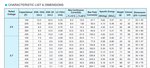

2. The supercapacitor used is a GreenCap EDLC DB (2.7V 500F) which is supposed to have an ESR of 3.1mOhm and a leakage current of 1.1mA
3. The C10 is a ceramic capacitor MLCC in 0402. It's supposed to have an insulation resistance > 10GOhm
4. The Vcap to EN/MODE pins via the BAT54C Schottky diode should only leak 5µA = 2* ((2.1V - 0.1V) / 800kOhm)
So I don't explain the large current consumption I'm seeing.

Schematic:

  • Schematic with a better resolution???

    If I have a correct understanding, the problem is that when the Vin supply for the TPS61094 is not present, and it works in boost mode (input energy from the super cap), then there is a big additional current consumed in the TPS61094 VOUT, right?
    If so, please do a quick experiment to check whether it is the problem in the TPS61094.
    • Disconnect all the load at the TPS61094 VOUT.
    • Make the Vin supply work normally, then the super cap will be charged. Measure the voltage at the VIN, SUP and VOUT pins.
    • Remove the Vin supply. Measure the voltage at the VIN, SUP and VOUT pins.

    The circuit works fine as expected. The documentation was good and we've made no mistake, I think, in the implementation. That is: we have the capacitor charging when Vin is present (although, it never charges at the specified charge current, it's always lower and non constant, but there was no mention it should charge in constant current in the datasheet). Vout is always present when both Vin is present or when it's not present and it has the expected value and almost no ripple. So the automatic Buck / Boost mode works perfectly fine.
    In the datasheet, the SUP pin is connected to the supercapacitor only. We have a smaller, MLCC 100nF capacitor in parallel to the supercapacitor, labelled C1 in the schematic. It's not in the datasheet, but it's found in many schematic using the TPS61094. I was wondering if this small filtering capacitor could be the reason for the additional leakage/wasted current we are experiencing.

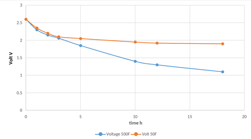

    We've instead swapped the 500F capacitor with another one (50F) to check if the behavior was the same. The energy leakage was 5x lower with the smaller capacitor (we measured ~5.6mW for the same test).

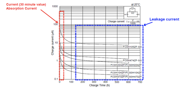

    So we sampled the spare capacitors we had to check for their self discharge rate. It was a statistical challenge, but in the end, on a bench, the 500F capacitors had a varying capacitance going from ~300F to ~600F, and a self discharge power from ~7mW to ~20mW, depending on the initial voltage stored in the capacitor.
    There was no mention of this behavior in their datasheet, so we've checked for other manufacturer's datasheet and found this:
    I wonder this is the case for all EDLC capacitor. In that case, it means that the leakage current found in the datasheet only happens after 72h, but also only when the voltage is already very low (and thus, without almost any energy left in the capacitor to extract). Since the TLS61094 stop extracting energy when the capacitor voltage is below 0.7V (and that you need to derate the supercapacitor to get the expected cycle life), the only usable voltage range goes from 0.7V to 2.2V (for us). The capacitor will plateau at ~1.0V after 18h, with only, no load, self discharge.
    This is what we measured with the two kind of supercapacitor under sampling we had:
    The bigger the capacitor, the higher the discharge rate, so whatever the size of the capacitor, it's not possible to get enough energy left after 24h. In the small capacitor case, the additional load of the circuit will deplete the energy and in the big capacitor case, its own self discharge rate will do the same.
    When the manufacturer communicate its leakage current after 72h, it doesn't matter anymore, since after 72h, the voltage of the capacitor will be too low to be usable anyway, so it's a shitty behavior from the manufacturer. And the manufacturer doesn't communicate the self discharge curve of the capacitor, in a dishonest move, IMHO.
    So this means that this kind of supercapacitor is not usable in our application, we won't be able to maintain the system operating for more than a day on a supercapacitor alone whatever the capacitor's value due to it loosing too much of energy by its self discharge current. I don't think anything is wrong with the TLS61094, it's just that we were bitten by the EDLC promises and the untold truth about their actual self discharge characteristics
