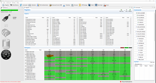

  • Hi Alan,
    Many thanks for your response.  Indeed the INIT flag is turned ON. In my application, we interface the Fuel Gauge IC with an MCU via the SMBus. What I noticed is that when I hold the MCU in reset while the BQ is being pulsed by the charger. The Fuel Gauge does exit the Shutdown mode as expected (quick).
    Question.
    Is there any other condition thats required  so the IC to exit shutdown mode - other than applying a pulse to the P+ to get the fuel gauge out of shutdown mode ?  e.g. no comms on the SMBus,? or the fuel gauge should not see any current drawn when waking up?

  • I suspect that it's something to do with my gg.cvs files but cant quite point to it yet. Tests are ongoing.
    Please find attached my gas gauge files—one that works fine and another that experiences a wake-from-shutdown delay.
    My main question is regarding how the Data Memory > Gas Gauging section functions, specifically how these values are updated -  is it an automatic process based on IT algorithm - over time? or these values need to be set from the onset.
    My application uses a 4S1P configuration. You'll notice that the difference between these two files is an additional cell Qmax value being added.
    It appears that the key to resolving the issue lies in this difference between these two files.
    I appreciate your insights!
