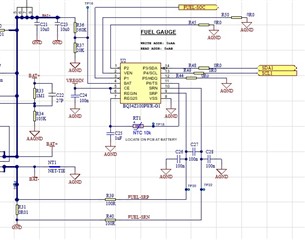

  • Hello Alan,
    I noticed that on our board pin REGIN (power supply input, i.e. input to internal LDO) occasionally sinks around 20mA (Tpulse=125ms, once every 1s). Which seems to be well above any value for ICC specified in the data sheet (145uA nominal (Table 6.3) & 10mA ICC(PROG) MAX (Table 6.12)).
    I suspected that current may be going to Vss (i.e. GND) via VEN pin (not used in our design), which was tied to Vss (as suggested in the data sheet).
    I inserted 11R resistor between VEN and Vss and checked voltage across it on a DSO - there was 220mV pulse (Tp=125ms, every 1s). That matches 20mA current pulse coming in via REGIN pin.
    That current pulse imposes about 2.5mA of average ICC current (well above 145uA value stated in Table 6.3). In our case, this may yield about 1.8Ah over 30 days in standby mode, which is too much for application.
    Would it be correct to conclude that VEN is not a simple open-drain (it appears more like a low side switch with an internal load (current source?). Otherwise, the chip seems to be working OK.
    1. Is such behavior expected?
    2. Would it be better to leave pin VEN floating? (In other words, should we be aware of any potential misbehavior if it is left floating?)
    3. Is there any other document that complements the data sheet with more detailed information about the pin characteristics?
    (I asked this question 20 days ago - it would be highly appreciated to get it resolved in next few days.)
    Kind regards
    Goran

  • Hello Alan,
    The schematic is attached.
    Few pointers:
    • VREGIN is connected to 3V3,
    • R36/R37 divider provides voltage feedback and
    • R31 is current sensing resistor.
    • SDA1 and SCL1 have pull up resistors to 3V3 on other side (not shown).
    The following contradicts data sheet: "It is best practice to leave VEN tied to Vss since false signals can come from EMI, ESD and etc. "
    Judging by Figures 8-3 & 8-4 in the data sheet, VEN is unlikely to be an open collector. Without some kind of internal pull-up, the gate of MOSFET Q4 would be floating in some states (e.g. when SW1 open & VEN off).
    Hopefully this will help to move closer to a resolution.
    Kind regards
    Goran

  • Hi Diego,
    That is obvious from the data sheet and does not answer my question (and has been already refused as a plausible answer in the previous replies).
    As you can see from our schematics we do not use VEN pin to drive voltage divider and VEN is tied to VSS, via R50 (0R0, so effectively short connected to VSS as suggested in the data sheet).
    As our battery voltage is 24V, current trough voltage divider (connected to pin BAT) can't be more than 24V/(560k+20k)=42uA or in the worst case 24V/560k=43uA. In addition, that current comes directly from the battery, not via REGIN. So, that eliminates the voltage divider as a culprit considering excessive current pulses of 20mA.
    In our tests, we found excessive pulsing current entering REGIN pin from an external 3V3 linear regulator, to which it is connected. (To avoid any misinterpretation, that is the current that goes into REGIN pin only, not a current from the regulator that may be shared with some other loads - it solely goes into REGIN pin).
    In the data sheet I found that the typical supply current in normal mode is Icc=145uA, while max Icc is for flash memory write mode, specifically Iccprog(max)=10mA.
    We are seeing a periodic current pulse (peak 20mA, with duration of 125ms) all the time. Simple comparison of observed 20mA vs the stated 10mA suggested that it may not be caused by the flash memory write mode, so I continued the investigation.
    What I found is that the current pulse that enters into BQ34Z100PWR-G1 device via REGIN pin, exists via VEN pin - approximately 20mA peak on both pins. To me, it suggests that no other pins contribute to the observed current pulse (e.g. nothing to do with the voltage divider connected to BAT pin nor VEN being an open drain).
    Here is how I tested VEN pin. The original R50=0R0 was substituted with 11R resistor and voltage drop across it was  observed by a DSO. Clearly there was 220mV pulse (Tp=125ms, every 1s initially, then after some time every 20s), which corresponds to 20mA pulse going from VEN into VSS.
    I couldn't find anything about this pulse in the data sheet and have two simple questions:
    1. Is the observed behavior normal?
    2. What are electrical properties of VEN?
    Among other things, your colleague suggested that it is an open drain output, which is hard to believe for the following two simple reasons:
    • If it is an open drain (ref. to VSS), it couldn't source 20mA. (If it is ref to VDD, obviously the data sheet suggestion to tie it to VSS when not used would be totally wrong.)
    • Considering the schematic of your evaluation board (Figure 8-4 in the data sheet), if VEN is an open drain output, wouldn't gate of Q4 be left floating whenever VEN is off (in Hi-Z state)? In other words, would the gate of MOSFET Q4 be left without bias? (I don't believe so.)
    (From the perspective of what I have observed, why should I accept suggestions such as that the issue is caused by the voltage divider or that VEN is an open drain? After frustrating 4 weeks of going around in circles in this forum, I expect to get a plausible answer soon.)
    Kind regards
    Goran
