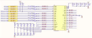

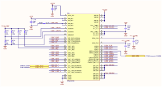

I've added TUSB546A-DCI in conjunction with the TPS65987D controller for a USB port to support both USB3 and DisplayPort functionality. I would like a schematic review to verify my design if possible.
