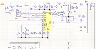

hi TI,
I received a message from our customer that a lamp had failed that uses the TPS92692-Q1 controller (boost mode).
After disassembly, it turned out that the voltage applied to VIN was present on both VCC and VREF. I could not find a short-circuit on the PCB (with and without the IC on the PCB).
VCC is only connected to a decoupling capacitor
VREF has a couple of 7400-series logic, an opamp and a comparator connected, (and associated decoupling capacitors).
Is this a known failure mode? Any guidance would be helpful.

  • hi Daniel,
    This has happened on a single prototype board.
    Input is 12V (9-16V), output is 200mA at 42V, 432 kHz switching frequency.
    U2 is supplied from VREF
    There is some more circuit below, but that has been disabled.
    Because we needed a containment action for the customer I was not able to measure the faulty board beyond checking for shorts and damage to the PCB before moving on towards getting the customer going again. I also needed to re-use the faulty PCB in the lamp for that 'fix', so I sadly don't have access to the PCB to capture waveforms.
    The lamp has been in the test mule vehicle for driving tests, so it could be from customer testing, but I did not notice any damage around the TVS (D6).
    kind regards,
    Thijs
  • Hi Thijs,
    Unfortunately this is not a known mode of failure and the IC is likely damaged. Please contact the quality team and have them evaluate the part. Meanwhile, you can try replacing the IC with a known good one.
    Sorry, there is not much more I can do without wave forms
