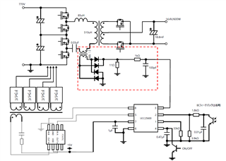

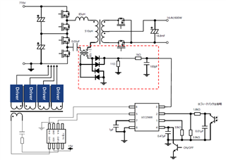

UCC25600: circuit of CT for the Overcurrent protection pin
Part Number: UCC25600
Other Parts Discussed in Thread: UCC25660
Hi all,
i'd like to be checked the circuit.
I was asking the question in the thread below.
(+) UCC25660: ISNS has an indefinite value when turned on - Power management forum - Power management - TI E2E support forums
My customer is considering using UCC25600 instead of UCC25660.
They are considering a current detection circuit using CT for the Overcurrent protection pin of UCC25600 as a full bridge LLC controller. (Red frame)
I would appreciate if you could give me some advice.
