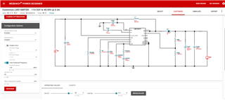

Hello
I have the same issue, the compensation values that are output by Webbench and the calculated suggestion in the sheet differs.
What am I missing ?
webench.ti.com/.../SDP.cgi
LM5157-58_Excel_Quickstart_Calculator_for_Boost_Converter_Design_V1_0_0.xlsx
Clément
  • I believe it's due to the output capacitor, I had put the big capacitor value we have further on the output of the component in the excel file.
    But I believe I should not take into account for the close loop compensation computations.

    Kindly, use the same power stage component values in both tools.
    The output cap and its ESR have a prominent effect on the close loop compensation calculations.

    I am talking about the output cap of the boost converter. The output cap is the part of control loop and changing its value would impact the close loop stability.
    If you have a big cap at the output of boost in excel calculator, you need to use same value in web bench because same formulation is used in both tools.

    Adding excessive output capacitance can shift the dominant pole and reduce phase margin, potentially making the system unstable if the compensation is not properly adjusted.
    Moreover, If the output capacitor is too large, the system’s ability to respond to fast load transients might be reduced. The controller may not react quickly enough, causing momentary voltage deviations.
    kindly, design your compensation network while considering the output cap.
