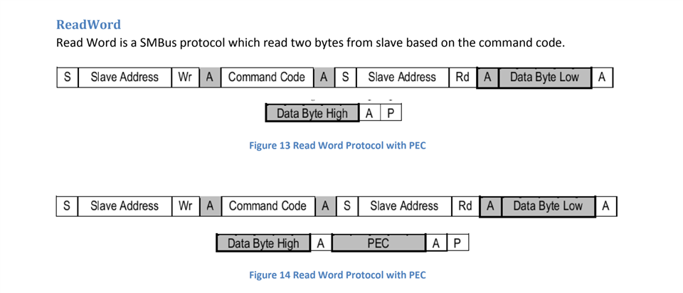

    RESET_COUNT is a write/read word command. Please follow below protocol
    reading MFR_REVISION shall have not impact on RESET_COUNT

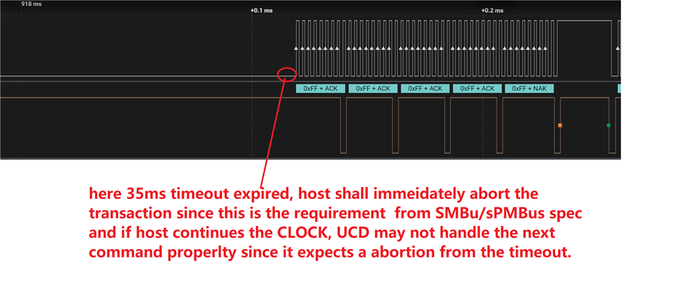

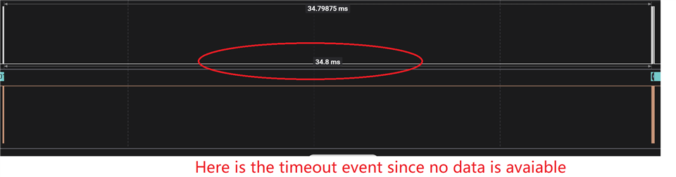

    however the nack happens when writing the address for the write, the power sequencer also does a clock stretching that lasts 34 ms

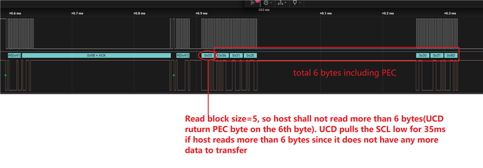

    P.S. In this capture you can see the clock stretching that the power sequencer is doing during the read of the MFR_REVISION, those 5 bytes are the lasts of a 12 bytes read.
  • This is the logic trace, in case you can open it, so you can have a full picture of what is happeningLogicTrace.zip

    Thank you for the log. I can see what the problem is.
    MFR_REVISION is a block read command. if host is trying to read more bytes than it is supposed to be, there will be a timeout event since UCD does not have more data to transfer. and after timeout. Host shall stop the transaction immediately instead of continuing on the existing transaction.
    The following correction is required on your software side
    1. for the MFR_REVISIOIN, please only read the required bytes
    2. when a 35ms timeout is present, software shall abort the transaction immediately by issuing STOP.

    We were reading 12 bytes because there is no better description of that register and the command reference manual SLVU352G seems to imply that there are 12 bytes. We were ignoring the data length assuming it would be 12 anyway... we didn't spot that incongruence.
