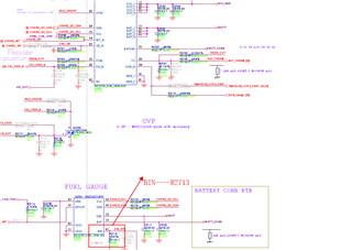

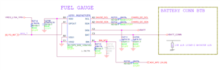

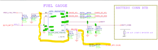

      i‘d like to use external NTC on BIN pin of BQ27427 for cell temperature measurement. I tried to use a 10K (1%) value resistor,connected between BIN and VSS on design board at room temperature.
and pull up 10k-R2713 resistor  on VDD;
If the pull-up resistor R2713 (10k ohms) on the BIN of the battery gauge BQ27427-0 exists, the NTC detection temperature error of our battery gauge is about 30 to 40 degrees; but if this pull-up resistor is removed or replaced with a 100k ohm resistor, the NTC detection temperature error is about 6 to 10 degrees.
my question:Based on the 10k ohm pull-up resistor circuit, how can we obtain the correct problem value?
attach my schematic .
