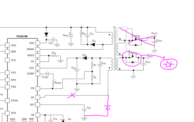

  • Hi Ryker,
    Thanks for your additional information.
    1. For TPS23758, one additional possible cause is the sync FET on 2nd side may be influenced. Can customer try with a diode on 2nd side and disconnect the CP pin with a 100V diode replace for PSR?
    2. Also for boards with 4 layers or more, normally you can have a sufficient area to pull the GND polygon, does customer accept redo the layout?
    3. Pulling DEN to VSS will make the PD's internal hotswap between RTN-VSS turning off. It is not an official reset. But it is good to try.
    May I know what is the behavior when TPS23758 fails? I assume you do not have Vout, but will the TPS23758's VCC-RTN drop and will the TPS23758's FB-RTN or COMP-RTN drop?

  • Hi Diang,
    Thanks for your suggestions.
    1. I have told customer the suggestion and let them try the suggestion.
    2. Customer is using 10 layers board now, you can refer below PCB file from customer.

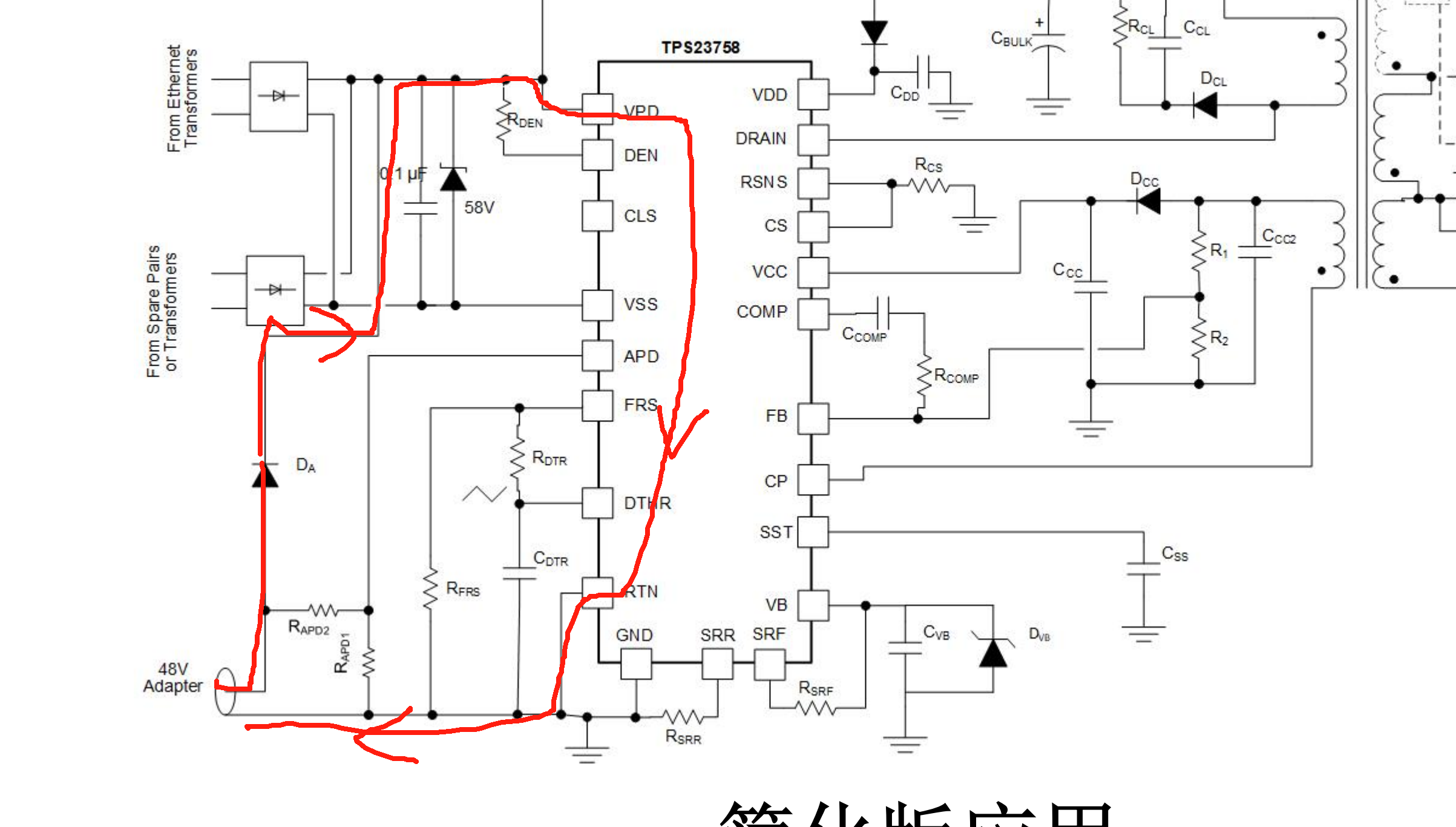

  • Hi Ryker:
    - TPS23755 has PD CTL and PWM CTL. At 12V the PD CTL part is not fully working. The PWM CTL part could work.
    - For me it is the most straight forward way to reset. Other ways like DEN pull down may not work and harder to be implemented
    Diang
  • Hi Diang,
    Does the PD controller belong to PoE detection part? Thanks.
    Ryker
  • Hi Ryker,
    Yes, roughly PD CTL is related to all VSS based pins including DEN, sourced by VDD-VSS. Roughly PWM CTL is related to all RTN based pins, internally sourced by VDD-RTN and VC-RTN.
    Diang
