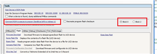

  • I can use the memory debugger in Fusion Digital Power Designer to switch applications. Using the available "Command ROM to execute its program ..."
    But I want to do the same thing from my firmware.

    Sending the 0xF0 command to address 11 within the UCD3138A will be difficult to do, since that would require modifying the Boot ROM firmware. The Boot ROM will need an external PMBus command to tell the Boot ROM to switch to Program Mode. Our examples use the Fusion GUI via the USB-TO-GPIO2 adapter but you can also create an external PMBus host to send the same command.
    The standalone Fusion API can be replicated on an external MCU, an automated Windows computer or a mini computer (ex. like a Raspberry Pi).
