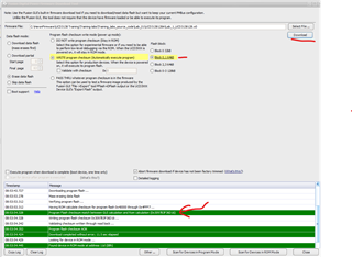

I downloaded my application and added the checksum as follows:
The check sum is: 0x3097B3F36D16
The bootloader then successfully boots the program so I know the checksum added to the end of block1 is correct (at least the bootloader thinks it is).

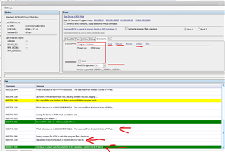

I verified this is correct using the fusion gui here:

The value I calculate in my firmware with the function included below, is:   0x18F9B3F36D16 while the value fusion GUI calculates is  0x3097B3F36D16.

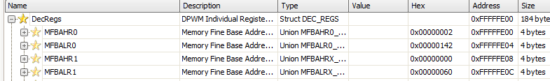

    Perhaps my Memory Base Address Registers are not correct?  HEre are the MFBAHR1 and 17 registers.
    Can someone check these? I just used the defaults.

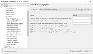

    You can try looking at the .map file directly using a text editor (like VS Code) and see if the register address matches the register value shown in the memory debugger. I have found that sometimes the memory debugger is different than the .map file. Also, confirm that the file location you have selected in the memory debugger is the correct location. I assume you are using the Bidirectional DC/DC firmware as a starting point. That firmware file structure is different than typical UCD3138 file structures.
    I believe that firmware also does not have .pp files enabled. You can find the settings for the Parser Preprocessor (.pp) directives in Project Properties → Build → Arm Compiler  Advanced Options → Parser Preprocessing Options. Select manual mode and check the bottom two options. Make sure the .pp files are generated in the same folder as your .map file and point to that folder in the memory debugger.
    Jonathan Wong
  • I can use the memory debugger to calculate and program the checksum correctly. This is verified because when I reboot the device, the bootloader verifies that the checksum is correct and boots the application correctly. However, when I run my application function to verify the check sum, I calculate a different result. I did check the memory map and pp files to be sure and do not see any differences between the debugger and the memory map. The (.pp) files are updating when I compile, as well.

    • The Fusion GUI checksum calculates the checksum across the entire program flash bank (128kB if you select all 4 blocks). Your function may have a different end_address than the Fusion GUI and thus stops the calculation at a different location.
