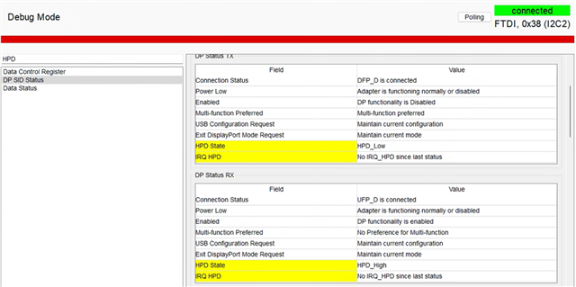

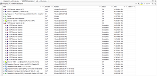

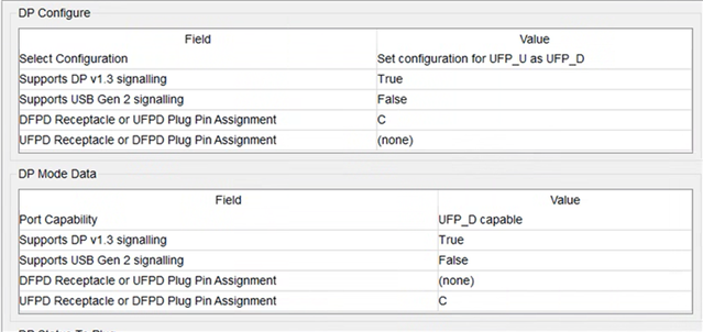

* When we connect display which support USB alternate mode, we can not confirm HPD output from TPS65987DDK.
We will use role as only DFP and use only DisplayPort signal (No USB3 signal required).

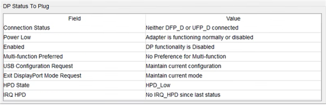

Here is status register(0x58) result when we connect display.
When we connect display which support alternate mode, we can confirm status change about "HPD State" of DP status RX, however we do not observe status change of DP status TX.
We will check 0x5F status register as well, however if you have any point which we need to confirm, could you please let us know ?
