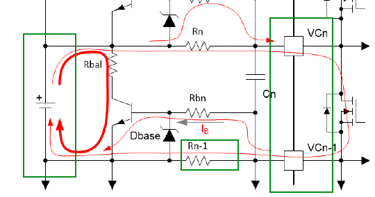

    Did you test the waveform of below points circled in green?
    You can also read the Cell Balancing Active Cells() to see if AFE activate the balancing on unwanted channels.
    BRs

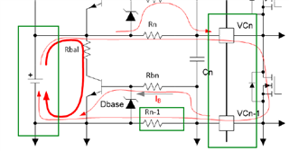

  • Hi Vamsi,
    Are you connecting the external FETs like the image I show you? Can you take a screenshot of your schematic?
    BRs

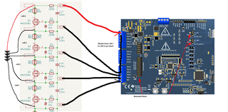

  • This is the schematic from our custom PCB we made, which was not working due to some design issues. But i am connecting EVM board to this part of the schematic using some wires for external FETs.
    (Please ignore FETs direction in this schematics. Actual pcb has correct orientation.)
  • Hi Vamsi,
    The sch looks good.
    Can you test a waveform of the points i showed before?
    Are you using resistor ladder to simulate cell? You need to use actual cell for the balancing test.

  • Can you test a waveform of the points i showed before?
    Sorry, I didn’t understand the points you meant . Can you be more specific, it would be better if you can point out in the schematic where i should check the waveform.

    I using real cells with 4s configuration, connected to VC0 VC1 VC2 VC15 VC16.

    You said you have fluctuant voltage reading when using external FETs. Taking cell 2 as example, I want the waveforms across R56, R53, Cell2-to-Cell1 and VC2-to-VC1.

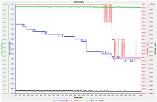

    Apart from the above data i also have saved graphs for both internal and external fets from BQ Studio
    Internal FET graphs, you can see the graphs and they dont have fluctuations much except for the cells which are balancing C1 and C16. after some time balancing is done and it stopped the balancing.
    External FETs: this graphs is for external FETS and we can clearly see the voltage fluctuations for all cells. Balancing never stopped and it continued to drain the batteries.

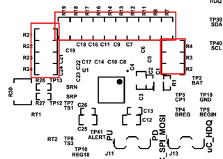

    • Did you connect the external circuit to BQ76952EVM connector with the R14-R28 connected? The EVM board also has this circuit on board. You should remove it.
    Did you mean R2-R24? yes, they are still there.
    I will remove these and check. Should i also have to remove capacitors?
    Thank you

    I noticed in a gg file you have Vcell Mode = 0x8007, which indicates you are using VC16-VC15, VC3-VC2, VC2-VC1, and VC1-VC0.  Then do you have VC4...VC15 pins all shorted together?  If the Vcell Mode isn't set properly, the device may be trying to balance a cell while a measurement on that cell is underway, causing corrupted measurements.
    you can refer to the image i uploaded for connections in the previous messages. Let me know if they are any issue with that.
