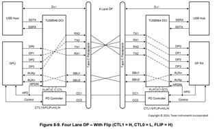

We are facing display issue when we use combination between TPS65987DDK and TUSB546.
I'm asking same question to TPS65987DDK support team, however, I would like to confirm this from viewpoint of highspeed signal.
We configure custom board as DFP only with alternate only mode(DisplayPort). (This means we do not use USB3.x)
We could get HPD signal from TPS65987DDK after CC negtiation and input this signal to TUSB546 correctly.
However, we are facing following issue.

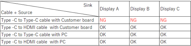

 * We observed that we can NOT confirm display when we use Type C to Type C cable with customer board.
Here is detail.
We did test with several pattern. We could not confirm display case of type-c to type-c cable with customer board image source.
To check whether this issue is related to cable quality, we did test by using PC as image source. However, when we used PC as image source, we could confirm display on any case of display.

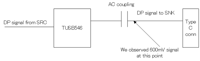

We confirmed HPD is asserted and also confirmed DP signal at near of type-C connector (checked signal after passing through AC coupling (approx +/-600mV) in all following cases.
The first question is below.
Q. Is  +/-600mV which I described above expected signal level ?
    Yes 600mV is about expected. Have you tried both orientation of the USB-C cable?

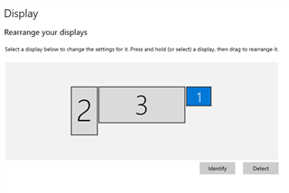

    Are you able to have multiple displays connected to this host?
    If you are. Then you can do the following tests to wee where the hang-up is.
    1) connect monitor 1 to host ideally HDMI to DP
    2) connect monitor 2 to host
    3) on monitor 1 see if monitor 2 is detected in display settings
    4) see if you can read information abut the monitor such as resolution an refresh rate in advances display settings

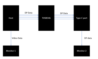

    Let me confirm what you imagine.
    Do you assume "Host" is PC ?
    If possible, could you show the configuration image ?
    The setup I imagine is something like this:
    Is this possible with your system? Does your system have more than 1 video out port?
  • Testing would be completed on monitor 2 and monitor 1 would be a reference
    Make sense !
    Here is our configuration.
    We have two different display out. However, we could NOT output these two at the same time.
    Looks like we will not be able to use the setup I proposed. Are you able to connect the outputs of the type-C port to a scope using a compliance setup?
    Looks similar to this:

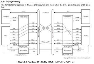

    My theory is that with HDMI across type C there is no lane swap meaning links[0-3] out will connect to links[0-3] in respectively.
    However for DP across type-C the cable connections are not as straightforward: Are you able to try all 4 scenarios and see if one works?
    Another way to look at the system would be as follows. Can you confirm that the DP lanes are correctly routed to the type-c pins?

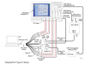

    It is difficult to realize this setup at this time.
    I'm not sure which setting sink side is applied, however from viewpoint of source side, eventually I connect "DP0P DP0N signal to "A10" and "A11 of type C connector.
    Do these four case mean I use same cable but change insertion pattern ?
    Yes, we confirmed waveform after AC coupling both figure 8-8 and figure 8-9 case depending on cable orientation and this was expected route.

  • Do these four case mean I use same cable but change insertion pattern ?
    Yes, try normal and flip orientations at the connecter for the DP alt mode source and the connector at the DP alt mode sink.

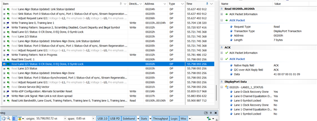

    I got AUX log by using PD analyzer(ellisys's analyzer).
    I included 4 pattern.(Please see attached zip file)
    1. Source is PC and connect to our(TED) monitor.
    2. Source is PC and connect to customer's monitor.
    3. Source is our custom board and connect to our(TED) monitor.
    4. Source is our custom board and connect to customer's monitor.
    (Above "1" and "2" are case of "Displayed". And above "3" and "4" are case of "No displayed".)
    It seems that we can see communication all case, but the contents of the log of "No displayed" case appear to be less than "Displayed" case.
    Is there any idea which point we should check ?
    EllisysAnalyzer_20250502.zip
  • HI,
    What I'm looking for in these files is where in the DP link training comes to a halt. Based on that information we will be able to isolate the issue further.
    I am unable to open the CTRT files.
    What software are you using for the aux log? Are you able to share in a different format/ send me the link to the software used?
  • What what I have seen between this thread the the PD team thread:https://e2e.ti.com/support/power-management-group/power-management/f/power-management-forum/1497385/tps65987ddk-hpd-assertion-issue
    It looks like aux is communicating properly as well. This issue likely is that link training is failing.

    When you can install tool, I would like you to confirm. However, according to AUX log, it seems that link training (CR and channel EQ) was performed properly.
    (Finally, I could confirm "CR done" and "EQ done" on the log.)
    It seems that the link training happens ok as well. I notice that the source data seems to be eDP which is supported by our part, but ASSR scrambling is typically not supported by monitors. Is there a way you can disable ASSR on the incoming data/ enable the monitor to decode ASSR?
