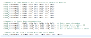

Hello! I am trying to use the BQ79600 and the BQ79616 to create a simple prototype. Our system has one stack device and one bridge device, but we are running into problems receiving the data back from the bridge device. We can see the serial communication between the bridge device and the stack device, and we can see the data being transferred, but SPI_READY never triggers back high after triggering low, so we never receive any data. I have attached an explanation document with Waveform photos and code photos. We are using the STM32 Cube IDE and the STMf042k6t7 microcontroller for our main microcontroller for the system..
WAVEFORMSHELP.docx
  • These arrays are what I send during auto addressing. I set the system up as one bridge device with one stack device with the one stack device being top of stack.

  • Hi Melana,
    Sorry for the delay. I wanted to speak with one of my colleagues who is more familiar to software on our devices, and he wasn't in last week.
    I went through the data which you sent and there does seem to be an issue between MCU and base. I have a few questions so that I can debug this:
    1) This is being tested on EVMs? Are the EVMs configured correctly?
    2) Can you send me the logic files so I can take a look at them myself?
    3) If this isn't on an EVM can you send me the relevant schematic?
    4) Can you read the following registers from just the base device?

    Hello! Thank you for that! We did try to send the one read command, but we ran into the same problem where SPI_READY never triggered back low. We are using the EVAL board for the BQ79616, but we are using our own PCB design for the BQ79600. We have attached our PCB schematic for review. I have also attached the exported CSV file from salea. I have the logic file, but it would not allow me to upload it. If there is another way I can get this to someone, I would be happy to do so.

    void Auto_address(void)
    	uint8_t wakeup[] = {0x90, 0x00, 0x03, 0x09, 0x20, 0x13, 0x95};
    	uint8_t rx_data[13] = {0};
    	//Variables to Dummy Write OTP_ECC_DATAIN1-OTP_ECC_DATAIN8 to sync DLL
    	uint8_t message1[] = {0xB0, 0x03, 0x43, 0x00, 0xE7, 0xD4};
    	uint8_t message2[] = {0xB0, 0x03, 0x44, 0x00, 0xE5, 0xE4};
    	uint8_t message3[] = {0xB0, 0x03, 0x45, 0x00, 0xE4, 0x74};
    	uint8_t message4[] = {0xB0, 0x03, 0x46, 0x00, 0xE4, 0x84};
    	uint8_t message5[] = {0xB0, 0x03, 0x47, 0x00, 0xE5, 0x14};
    	uint8_t message6[] = {0xB0, 0x03, 0x48, 0x00, 0xE0, 0xE4};
    	uint8_t message7[] = {0xB0, 0x03, 0x49, 0x00, 0xE1, 0x74};
    	uint8_t message8[] = {0xB0, 0x03, 0x4A, 0x00, 0xE1, 0x84};
    	//Variables to Enable Auto-addressing Mode
    	uint8_t message9[] = {0xD0, 0x03, 0x09, 0x01, 0x0F, 0x74};  // Enable auto addressing
    	uint8_t message10[] = {0xD0, 0x03, 0x06, 0x00, 0xCB, 0x44}; // Set Bridge device address ID
    	uint8_t message11[] = {0xD0, 0x03, 0x06, 0x01, 0x0A, 0x84}; // Set Stack 1 device ID
    	uint8_t message14[] = {0xD0, 0x03, 0x08, 0x02, 0x4E, 0xE5}; // Set all stacked devices as stack
    	//Variable to Set Stack 1 as both stack and top of stack
    	uint8_t message15[] = {0x90, 0x01, 0x03,  0x08, 0x03, 0x52, 0x20};
