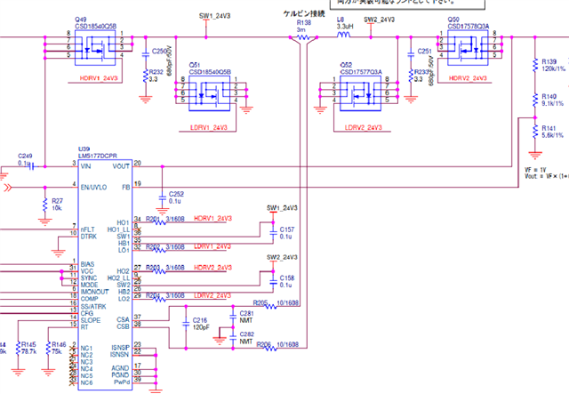

Hello, Stefan.
It looks like previous tags are closed.
So put the message through the new topics.
We changed the Nch transistor gate resistor as 0 ohm to 3 ohm.
It worked. Before change the value ,anomaly heating inductor less than VIN=20.8V,
after change the value, the phenomena didn't occur even if VIN=26V.
We really appreciate your support.

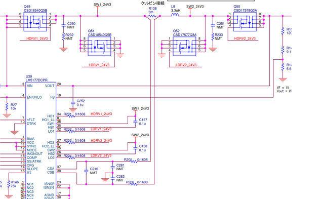

  • Hello, Stefan.
    We discussed in the topic of
    https://e2e.ti.com/support/power-management-group/power-management/f/power-management-forum/1446780/lm5177-anomaly-heating-phenomena-of-the-inductor-in-dcdc-converter-circuit/5661606#5661606
    We have an issue of anomaly inductor heating.
    When VIN is high (over than 19.5V) , this phenomena happens.
    As you mentioned , this phenomena occurs because of the current loop
    of CSA/CSB line is disturbed.
    So we made the filter of CSA/CSB line using 10 ohm and 120pF.
    Next, the trace of SW node close to CSA/CSB, so cut the line and reconnect using
    wire through the air.(not on PCB)
    After that, you advised snubber construction. so we made it.
    The result was before some change , VIN>19.5V phenome happens, after some change,
    VIN>20.8V phenome happens. So a little improved, but not so enough.
    Finally, we would some additionally change of snubber, but we change the gate drive
    resistor of NMOS.
    Satoru Oku
    Final schematic and wave form result.
  • HI Satoru,
    so if understood it right, the first two images are before the rework and the second are after the rework.
    So the results are much better and esp. the inductor current would look like expected.
    The ringing you see on the other signals are might be due to the connection of the probe (having a large ground loop).
    So my understanding is that you still see the inductor heating up for higher input voltages (> 20.8V) - right?
    But this is only on  few PCBs - right?
    How much does it heat up?
    Can you share scope plots of SW1 and SW2  and inductor current in the for the setup where you see the inductor heating up. (share a scope plot of a good and a bad unit)  - showing a few switching cycle ~ 5-8.
     Stefan

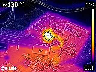

    it is over 100 C degree(212 F degree). (before improvement)
    After improvement, it is around 35C degree(95F degree)

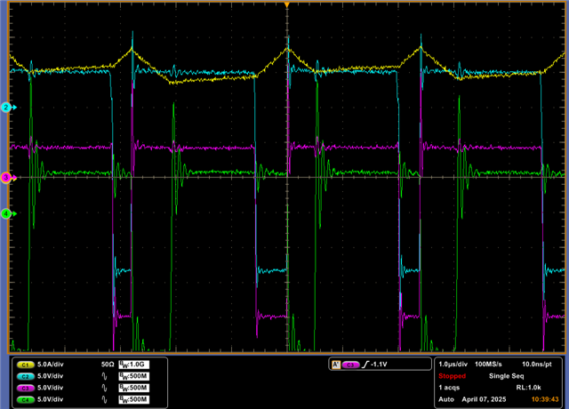

    >Can you share scope plots of SW1 and SW2  and inductor current in the for the setup where you see the >inductor heating up. (share a scope plot of a good and a bad unit)  - showing a few switching cycle ~ 5-8.
    How about these pictures. These are picture of same PCB. Before improvement and
    after improvement (we don't have good PCB.)
    Before improvement
    Yellow = inductor current  Sky blue = maybe gate of Q50? Pink = maybe gate of Q52
    After improvement
    Yellow = inductor current  Sky blue = SW1 Pink = SW2 Green = gate of Q50
    Satoru Oku
