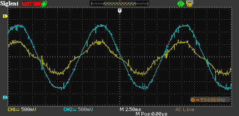

I'm trying to understand what is causing Input Current Waveform distortion on 2 boards I have.  They are both TIDA-00779 designs using the same PCB.  Board#1 is an exact duplicate with the same Mosfet hardware and an output voltage of 390V / 3500W.   (I'm using a slightly older PCB version from the most recent)  Schematic is attached below.
tidrka5 - Schematic.pdf

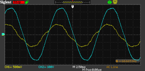

Board #2 uses the same PCB but instead of mosfets, I'm using Infineon IKW40N120T2FKSA1 IGBTs.  Instead of using UCC27324 drivers in Board#1, I'm using UCC27524 drivers in Board#2.  Board#1 uses 12VCC, Board#2 uses 15VCC to drive the IGBTs.  D1, D2, and D3 diodes in Board#2 are similar to the diodes used in Board#1 but are rated for higher voltage.  Board#2 also uses a Capacitor array with the same capacitance rating to Board#1 but with a higher voltage rating.
Below are input Voltage and Current curves for Board#1 and Board#2.  The blue line is voltage, yellow is current.  Both voltage and current measurements were measured from a voltage divider and a 0.01R shunt resistor signals passing through isolation amplifier circuits.
Board#1 @ 1500W - Resistive Load
Board#2 @ 1500W - Resistive Load
My intention was to trial running higher output voltages on Board#2 to around 650VDC but I'm noticing input current distortion issues even at 390VDC output voltages.  Both Board#1 and Board#2 exhibit the same distortion but it is much more pronounced in Board#2 than Board#1.  I would like to resolve the distortion issue before I continue testing at higher output voltages.

  • Hello StnGgc,
    As I understand this, the main difference between the two boards is the MOSFETs + drivers, vs. IGBTs + drivers.  Test conditions are the same.
    I attribute the slight difference in THDi to slight differences in turn-on and turn-off timing of the MOSFETs vs. IGBTs.
    Possibly there is also a contribution from differences of output diodes due to the higher ratings in the IGBT design.
    I suggest that, although detectable, there is not enough significant difference in the current distortion (in my opinion) to prevent you from raising the output voltage of the IGBT design.
    To limit risk of severe unexpected current distortion, I suggest increase the Vout setting in small increments, such as 25V or 50V, instead of jumping directly to 650V, and see how the input current behaves.  At each increment, you can gain confidence that the next increment will also behave correctly.
