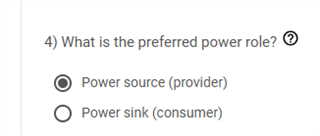

    Can you confirm the Preferred power role?

    What is the maximum power that can be sourced/consumed? 240W
    Preferred Power Role? Power Source
    Supported USB Highest speed? No USB Data
    BC1.2 Support? No

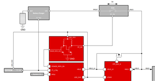

    What could happend if there is no battery connected to the system if using the BQ25756 configuration? Im also not sure on how the power paths is configured when power to be drain from the PD Controller is lower than 15W. Would the system drive power from the PP5V power path or if PPHV is configured only PPHV will be used for draining or supplying power?
    The TPS26750 will attempt to write to the BQ part via I2Cc.  If the voltage is not provided then the PD will fault (most likely under voltage fault on VBUS).
    The TPS26750 does not have a PPHV.  The power path, PP3, is the external power path.

    Looks like this was the main issue, we connected a 3s battery to the system and we were able to charge a cellphone from the battery and we stopped seeing that erratic behaviour.
    • The TPS26750 does not have a PPHV.  The power path, PP3, is the external power path.
    It calls my attention that in the advanced configuration only source PDO1 has the possibility of chosing the power path, is it not possible to configure other PDOs to use PP1?

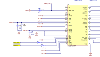

    We are having one more issue now that is that our battery looks like it is not beeing charged. After connecting a battery charger to the USB C port PP3 gets activated correctly and we see 5V at PPEXT.
    Then PG flag at the BQ25756 goes low meaning that we have a correct input at the charger but the STAT1 and STAT2 flags are both low meaning that charging is disabled.
    We have the CE input at the BQ25756 tied to 3V3 with a pull-up resistor, that means that in order to enable charging the TPS would need to set DIS_CE_PIN  to 1 and set also to 1 EN_CHG bit in the BQ
    Is there anyway to know if the TPS is doing this? Or can we manage to make the TPS to do this from the I2Ct interface? If not, the only solituion to this would be to place a pull down in the CE pin?
    The default value is PP3.  The ability to select PP1 is available but I will need to make an inquiry if that is a mistake in making that option available in the GUI tool.  We do not allow the configuration of the power path based upon the PDO, the intent is to only support the external power path.
    I can double confirm with the GUI team to understand exactly which writes are being made to the BQ from the PD, however, in the reference design the CE pin is pulled low.
    https://www.ti.com/lit/df/tidmdd3/tidmdd3.pdf#page=4
    Chris
    I was able to confirm that the PD does not set the DIS_CE_PIN in the I2C writes to the BQ.  The EN_CHG is controlled in the I2C writes to the BQ.
