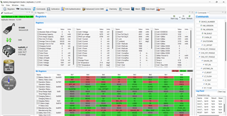

    When we discharged the battery under 500mA,It does not got terminated and battery pack failed.
    Screen shot also attached
    3666.gg.csv
  • Hi Max,
    The system is most likely moving in and out of shutdown mode at this point. The SDV bit is set signifying that the voltage is less than the Shutdown Voltage parameter, and the Voltage at the PACK pin (4799mV in screenshot above) is less than the Charger Present Threshold (13000mV in gg file) which would allow it to enter shutdown, but the Voltage at the PACK pin is still greater than Vstartup (~2.2V) which would cause it to exit. This cycle of the gauge observing these measurements is causing a cycle of entering and exiting shutdown.

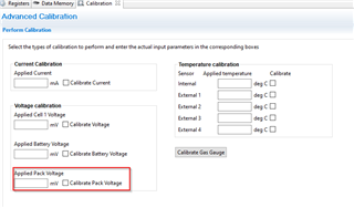

  • Hi Max,
    There is something in the system currently causing the Voltage at the PACK pin to observe 4799mV. If there is nothing connected to PACK at this time, and if the actual measured voltage at the PACK pin is 0, please try calibrating the PACK pin voltage in bqStudio:
    If this voltage is 0, then the device will be able to enter shutdown.
    Anthony

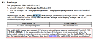

  • Hi Max,
    If possible, please share a log file of the gauge not entering shutdown when the PACK voltage is less than the startup voltage for us to review.
    Yes, if the battery is deeply discharged, PCHG_CMM will allow for 0V charging:
    Anthony
