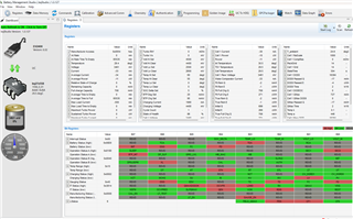

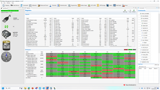

I'm observing a behavior where the voltage at which RSOC drops to 0% varies depending on the discharge current.
For example, sometimes RSOC reaches 0% at 3400 mV, while other times it drops at around 3100 mV. In particular, when RSOC reaches 0% at around 3400 mV, I noticed that the OCVFR flag becomes active.
After that, even if I begin charging with a constant current, RSOC does not update until the cell reaches full charge voltage. During this period, the OCVFR flag remains high.
