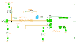

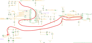

    I've attached the mark up down below of the schematics, also I can only do the battery gauge portion. The highlighted green portion is good and the blue is of concerns, " If an external thermistor is used for temperature input, the thermistor should be connected between this pin and VSS." Also wanted to validate the you have it as Batt(+) >> BAT >> SRX >> Load (+). As for the excel I agreed on point 3 about the comment but if you it is really needed you could possibility share the thermistor but it is better to communicate via i2c, lastly point 4 the biggest information that the battery gauge will give you is State of Charge (SOC), Full charge capacity (FFC), chemical capacity (Qmax), temperature and etc. You would need to read the Technical reference manual to better understand all the information you can get from battery gauge.

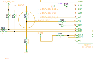

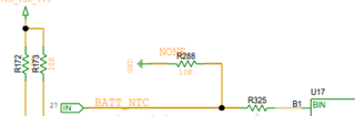

    --- I reserve battery NTC connection to both charger IC TS pin and fuel gauge BIN pin,  TS pin expects a pull up resistor to NTC and have a desent voltage on TS pin.  While BIN pin expects a low ( close to 0V?) voltage. Our fuel guage is on phone board, so we need to get battery temperature via NTC and it should be read from charger IC TS, not BIN?
    My question is that TS requires decent voltage while BIN require low voltage, how to handle this conflict? Or am I wrong on that?
    ---please help to check the following charging flow, is it correct?
    - The battery gauge does have an internal temperatures sensor that can be used if the battery gauge is place closely to the battery cell. However if you are sharing a thermistor with a charger than it would be up to the user to test to see it this is workable.
    - Yes the charging flow is correct for the battery gauge.
