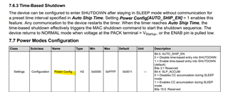

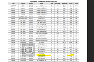

  • In the datasheet Power Config is
    and
    Why does Power Config have two different default values in Technical reference Manual ?

    In the above Schematics we have DNP permanent pull down of ENAB. We have set the auto shutdown   time to 2 min. after 3 min both the FETs CHG and DSG has gone to OFF state but the fuel gauge is sourcing current from battery, about 150uA and 75uA and its toggling. Pulled the ENAB to gnd but its not enabling the CHG and DSG FETs. ?

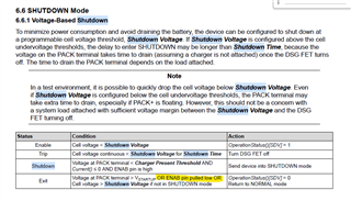

    Vstartup is 2.0V typical for this gauge. In essence this requirement means that if there is a charger present then the gauge will wake up from shutdown mode.
    How are you measuring the gauge iq? To obtain the gauge iq you must only provide power to the gauge through VDD and VSS, then you must take the average current consumed over at least a 30 second period. I have tested the gauge iq in shutdown mode for this gauge using the EVM and have measured an average iq consistent with the typical value we have spec'd in the device datasheet for shutdown mode.
    If you can communicate with the gauge, then it is not in shutdown mode. You are also correct, if ENAB is permanently pulled low then it is impossible for the gauge to enter shutdown mode. I recommend referring to the enter and exit conditions for shutdown mode listed in the device Technical Reference Manual.

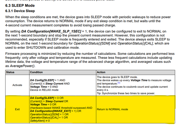

    The takeaway from your response is Vstartup is 2.0V typical for this gauge. But even if we connect a charger/pull the Enab low this gauge is not going into Normal mode. If the device is disabling CHG and DSG FETS after  Auto shutdown time, what mode is it in ? It will enable its CHG and DSG FETs once the battery is removed and re-insert it.
    Referring to the Technical Reference Manual
    We are doing this, But not exiting from the UNKNOWN mode gauge is in, but current through FG is 190uA when in MAX.

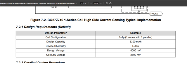

    Does TI have any Checklist or something for the USER to configure their Gauge with different battery's, for ex the if default capacity is 3000mAH, when we change it to 1000mAH what all parameters are to be changed.

  • Hello Sobin,
    This is dependent how much current you are pushing along with how you set your normal mode parameters, I would recommend looking into the exit condition parameters
    FET will be enable/closed when there is current movement across the sense resistor
    You are saying we cannot access gauge using I2C, so please confirm it will automatically get disconnected from BQSTUDIO ?
    -If you are using BqStudio that means there is communication going on meaning that it won't go into shutdown mode since the condition isn't meant. You can always access the gauge using I2C but it will cause a condition to exit it from shutdown/sleep/ship and etc.
    -Please reference the EVM and the datasheet.
