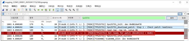

Hi team:
I encountered an error while downloading the patch bundle. When executing step six to read the 0x09 register, it should have returned 0x00 for all, but mine is not. The first number I returned was 0x06. According to the datasheet, 0x06 represents the invalid timeout value, but the timeout value is indicated in the datasheet to be set to 0x32, which makes me confused. I would like to ask what the timeout value should be defined as?

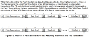

        // Step 7: Write Patch Data to I2C addr 0x30 register 0x01 (burst)
        size_t offset = 0;
        const size_t chunk_size = 16;
        while (offset < patch_size) {
            size_t len = (patch_size - offset > chunk_size) ? chunk_size : patch_size - offset;
            ret = msdk_i2c_write_reg(dev, 0x30, 0x01, (uint8_t *)&patch_data[offset], len);
            if (ret != MSDK_STATUS__OK) {
                MSDK_LOG_ERR("Failed writing patch at offset 0x%X", (unsigned)offset);
                return ret;
            offset += len;
        msdk_time_delay_ms(10); // Wait 10ms

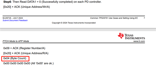

  • BTW.. Are you doing this on EVM? EVM has an EEPROM already on it.
  • Hi Li,

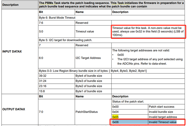

    To add on to Ghouse's question, my assumption is that you have the EEPROM disconnected on the EVM (removing JP16), correct?
    While reviewing the logs, I noticed that in Step 3, writing to DATAX register seems to be incorrect.
    859 1.861693 190 MCU 24 [M:msdk C:info F: L: ]: [MSDK][TPS25751] write_reg: reg 09, value 80
    860 1.861695 200 MCU 44 [M:msdk C:info F: L: ]: [MSDK][TPS25751] 80 77 00 00 30 32 00
    The first byte should be the byte count which is 06 and not 80. The timeout value should be in Byte 6.
    Aya Khedr

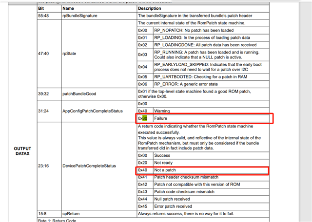

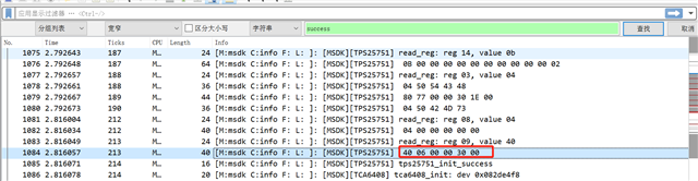

    We have identified the issue. There was an error when writing to the register in step. buf [0] should have been passed in as 06, but we passed it in incorrectly
    Thank you very much for your support!
    Best Regards!
    Iris
  • Hi Aya Khedr,
    Hello, we encountered an error during the tenth step, which showed that the patch was invalid. The following is the code and log. You can search for tps25751 in the logCould you please help us identify where the problem occurred? Thank you very much!
    Best Regards!
    Iris

    1158	2.812020	1391	MCU	24	[M:msdk C:info F: L: ]: [MSDK][TPS25751] read_reg: reg 08, value 04
    1159	2.812026	1391	MCU	40	[M:msdk C:info F: L: ]: [MSDK][TPS25751] Step 5: 04 00 00 00 00 00
    1160	2.812030	1392	DSP	16	[M:dsp_mw C:info F: L: ]: [DC COMPENSATION] Start\r\n
    1161	2.812033	1392	DSP	24	[M:hal C:info F: L: ]: DSP - Hal Audio Output Mode Setting, gain_select:0x0, dac_mode:0x0
    1162	2.812036	1392	DSP	24	[M:hal C:info F: L: ]: DSP - Hal Audio Volume Select:0, mode:0
    1163	2.812038	1392	DSP	28	[M:hal C:info F: L: ]: hal_device_convert_agent 768 if 0 is_tx 0
    1164	2.812040	1392	DSP	24	[M:hal C:info F: L: ]: hal_device_convert_device_agent 768 if 0
    1165	2.812042	1392	DSP	36	[M:hal C:info F: L: ]: #hal_audio_device_set_agent# device 0x300, agent 58, device_agent 7, type 0, on/off 1
    1166	2.812044	1392	DSP	24	[M:dsp_mw C:info F: L: ]: [DSP AMP] afe_send_amp_status_ccni [0x22410001], ack success from isr 0\r\n
    1167	2.812048	1392	DSP	20	[M:hal C:info F: L: ]: [Audio Agent] DSP - Hal Audio AFE control:1
    1168	2.812050	1392	DSP	24	[M:hal C:info F: L: ]: afe_set on agnet 58 device 768\r\n
    1169	2.812052	1392	DSP	44	[M:hal C:info F: L: ]: DSP - Hal Audio ANA DAC:0x7, Mode:0, Performance:0, rate:48000, dc_compensation:0x0, first_boot=1, CLASS-G Enable:1
    1170	2.812055	1393	DSP	24	[M:hal C:info F: L: ]: DSP - Hal Audio Volume Select:0, mode:0
    1171	2.812056	1393	DSP	24	[M:hal C:info F: L: ]: [Audio Driver]AFE COMMON GLOBAL, analog_select:0, enable:1
    1172	2.812057	1393	DSP	16	[M:hal C:info F: L: ]: [Audio Driver]AFE COMMON GLOBAL ANALOG INITIAL ON
    1173	2.812059	1393	DSP	20	[M:hal C:info F: L: ]: [Audio Driver]AFE COMMON GLOBAL ANALOG INITIAL STATUS = 0x01
    1174	2.812060	1393	MCU	24	[M:msdk C:info F: L: ]: [MSDK][TPS25751] read_reg: reg 09, value 40
    1175	2.812061	1393	MCU	88	[M:msdk C:info F: L: ]: [MSDK][TPS25751] Step 6: 40 00 00 00 00 00 00 00 00 00 00 00 00 00 00 00 00 00
    1176	2.812065	1393	MCU	20	[M:msdk C:info F: L: ]: [MSDK][TPS25751] tps25751_write_patch patch size 13184

    Also, I have one more question,The data we returned in step 6 is 0x40 0x00 0x00 0x00 0x00,But the byte count on the data book is 0x04, I don't know if returning 0x40 is correct
    Best Regards!
    Iris
  • Hi Iris,
    The Data Register 9h is 0x40 but only the first four bytes need to be read as 0's.
    I will review the flow another time and get back to you with feedback.
    Aya Khedr

    Okay, I'm sorry to trouble you.What is the log I printed in step ten:Step 10: 40 00 00 40 80 00 00 00 00 00 00 00 00 00 00 00 00 00,Instead of 0x40 0x00 0x00 0x00 0x00,According to the table, 0x40 represents not a patch, and 0x80 represents failure
    Best Regards!
    Iris

    It appears from your description along with the output data from Step 10, that the patch may be written incorrectly.
    See the following protocol outlined in the TRM:
    Also see attached example I2C logs of the sequence and how the patch bundle should be loaded (see line 18 for reference)
