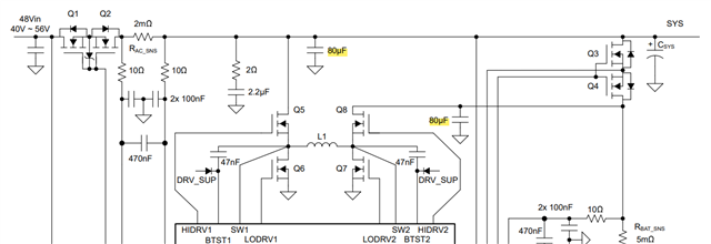

When designing BQ25750, there is a question: the location of the input and output capacitors. There is no clear requirement in the specification. The following screenshot:

1. Does BQ25750 have no requirements for the location of the input and output capacitors?

  • Hi Ethan,
    1.  According to the FAQ, it mentioned that the 80uf input capacitor should be 40uf+40uf on both sides of Rac. The output capacitor is the same. Right? But in the datasheet 80uF caps are both placed close to the MOS side.
    Datasheet:
    FAQ:

  • Hello Rannie,
    Thanks for working with this.
    1. The datasheet picture is just a simplification of the circuit and is not an exact drawing. Please balance the capacitors across the sense resistors.
