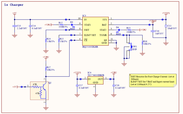

Dear TI Team,
I have calculated the power dissipation according to the 8.3.7.6 section in the BQ25185 datasheet, which turns out to be 1.21W.
Please guide me on the temperature rise based on my calculated power dissipation, how to calculate it, and which formulae I should use.
The following is the attached schematic for reference.
I am looking forward to hearing back as soon as possible.
