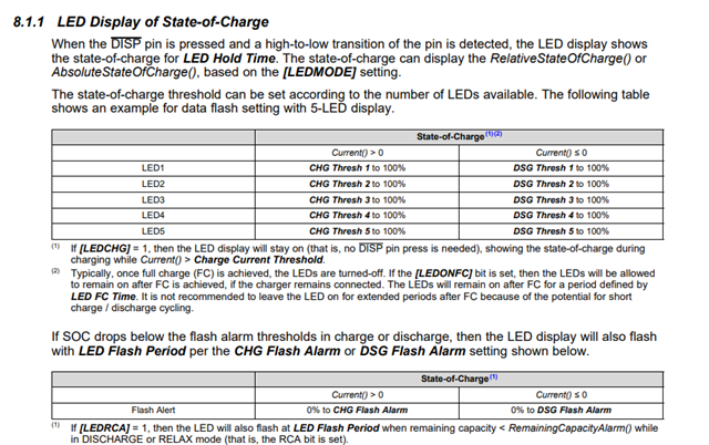

Hello team.
I have a question about the BQ40Z50's LED control capabilities. My question is, I'd like to know if it's possible to have the LEDs on while the battery is connected to the PACK+, as a signal that it's active. So far, I've only been able to get the LEDs to work when I pull the DISP pin low or when a charger is connected, but I'd like to have the LEDs light up while the battery is in discharge mode.
Thank you.
