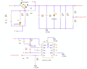

WE are using UCC27201A-Q1 for high side gate drive purpose. Our Operating frequency is 2kHz with maximum duty of 25%. We have used Boot-cap of 470nF/100V (X7R).
Vdd supply voltage is 12V. The HI pin gets input pulse amplitude of 5V. The 1.8V_out is available. But the HO pin doesn't give any output pulse and it remains at 0V during the input pulse high too.
It is not changing its pulse.
Kindly suggest If any mistake or improvement can be done.
