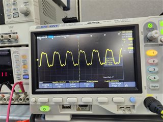

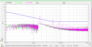

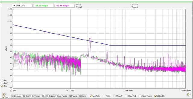

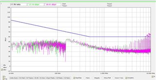

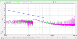

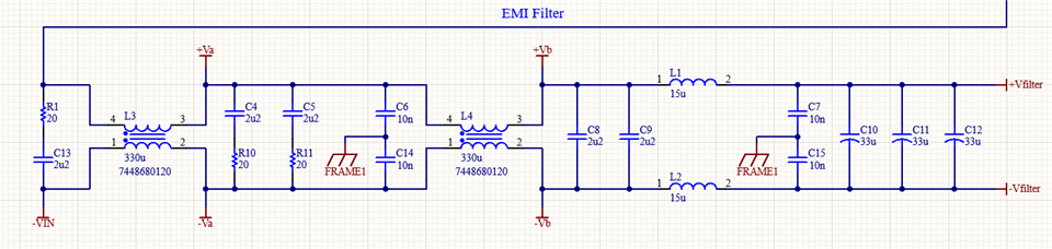

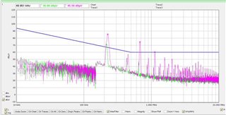

I am currently testing TPSF12C1 for use in filtering noise in DC/DC systems.
I found this forum post https://e2e.ti.com/support/power-management-group/power-management/f/power-management-forum/1505768/tpsf12c1-active-emi-filter-for-dc-dc-application/5787210?tisearch=e2e-sitesearch
where it is confirmed that this part can be used in DC/DC systems, but when using the recommended values from the TI quickstart calculator spreadsheet, I am getting poor performance that is only adding noise to the system.
Is there anywhere I can find guidelines or recommendations for how to connect this IC in a DC/DC system for optimal performance?
