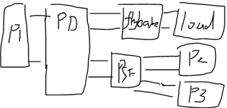

  • Hi Hugo,
    Thanks for reaching out!
    It looks like you need a PoE passthrough like below?
    If so.
    1. For class-6, you can use 1xTPS23730 (flyback controller integrated) as 1xPD input port, and 1xTPS23861 as 2xPSE output ports.
    2. For class-8, it could be 1xTPS2372-4 as1xPD input port, 1xTPS23731 as flyback controller, and 1xTPS23861 as 2xPSE output ports.
    Please find attached preliminary reference design for #1. You can upgrade Class-4 to Class-6 using TPS23730 to replace TPS23731, and using the 2nd channel of TPS23861 for another PSE port. TPS23731 + 12V Flyback + TPS23861 Passthrough_Sch (V3).PDF
    Diang

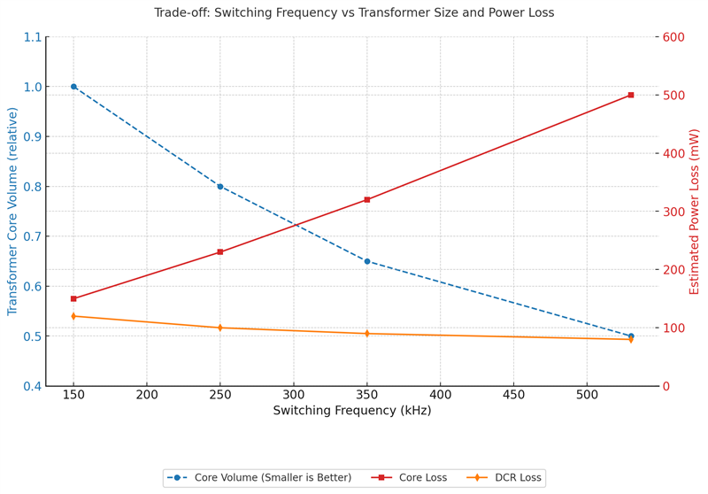

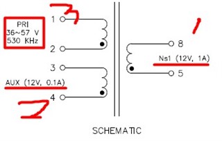

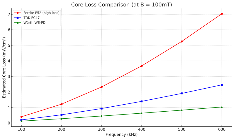

  • A few questions for you
    Q1: How to select a suitable Power Transformer?
    Q2: How about the switching frequency of TPS23730, TPS2373-4, TPS23861, TPS2372-4?
    As far as I know, transformer core loss is directly proportional to the switching frequency, assuming constant magnetic flux and core material. This core loss contributes to heat generation, which, in turn, affects the overall thermal performance and heat dissipation requirements of the transformer.
    P.S.:   frequency (kHz or MHz), B: peak magnetic flux density (T), x≈1.32.0 depending on material, y≈2.0
    Q3: I need to check any questionnaires or provide the specifications. of PoE PS/PSE to Transformer vendors?
    • Switching frequency (100KHz, 300KHz, 530KHz,....)
    • Topology (flyback, forward?)
    • Working mode
      • If it’s a Flyback topology, what’s the working mode? CCM, DCM, or BCM?
    • Input voltage
    • Need Auxiliary winding or not
      • If yes, what’s Aux. winding’s voltage and current
    • Saturation current
    • How many output
      • Each output voltage and current
    • Safety requirement
      • IEC 60950-1/ IEC 62368-1/ UL 1310 etc.)
    • Insulation level (Functional/ Basic/ Reinforced)
    • Need Hi-Pot (Dielectric)
      • If yes, Hi-Pot voltage standard and time: (1500Vac 1 minute or 1875Vac 1 second?)

    For the transformer, TI PoE PD chip switching frequency can be adjusted, but normally 100 - 500kHz, and 250kHz is most common and most of transformers are in this range. Details of transformer loss may be better to get the inputs from transformer vendors.
    12V Class4 250kHz PSR flyback transformer could be LDT1069-50R, 750320320, EP13A-1021.
    Hope above information can help. Let me know if you have other questions or concerns.
