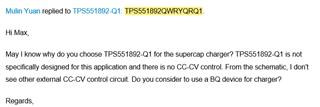

Hi Max,
To confirm, TPS551892-Q1 can be used as constant current source for super cap charging. It is a simple solution without rich features. To discuss, I am wondering why do you choose this part instead of a BQ part? Sorry for confusing you.
About the schematic, below is my feedback:
1. Input 6-16V, output 4.4V-6V, maximum output current 1A. Set output voltage is 4.8V, when Vout reaches 4.8V, the charging will stop. I think it will be better to set Vout target to 6V. Can you share your opinion?
2.For better transient performance, recommend to use a 4.7uH inductor with Isat>8A.
3.Change R744 to 0ohm.
4. Recommended compensation parameters: R749=10k, C631=6.8nF, C632=100pF.
5.Follow layout guideline.2275.TPS55289 Layout Guideline.pdf
Mulin
