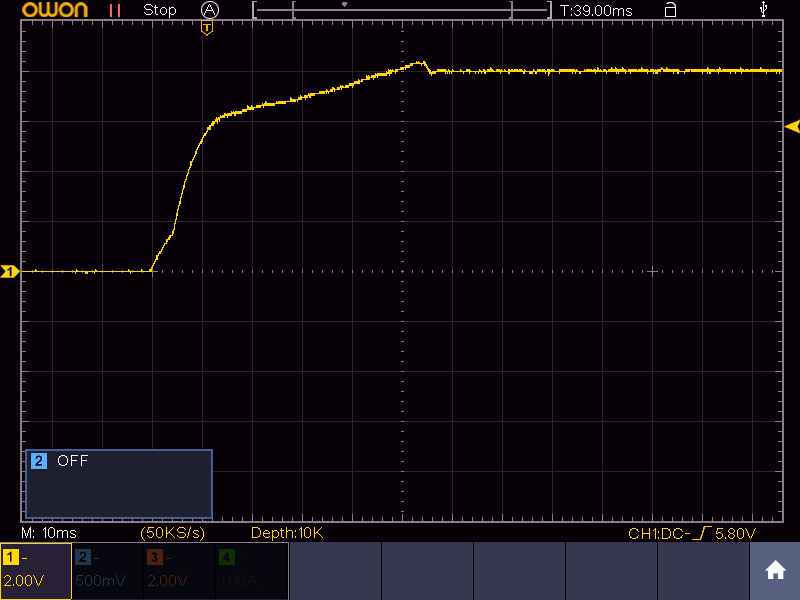

    Today I measured (after increasing R297 from 100R to 200R) disconnection load (2A), and here is output voltage: No diodes breaks. But I think this is not solution. System cannot switch of output, when there is not load (in real there is 100k resistor in pcb connected to output). In my device will be minimum load 100mA).
    Here is starting with R297 = 100R:
    and here is the same starting with R297 = 200R
    It looks the same. I'm interested too, how to decrease little overvoltage in starting.

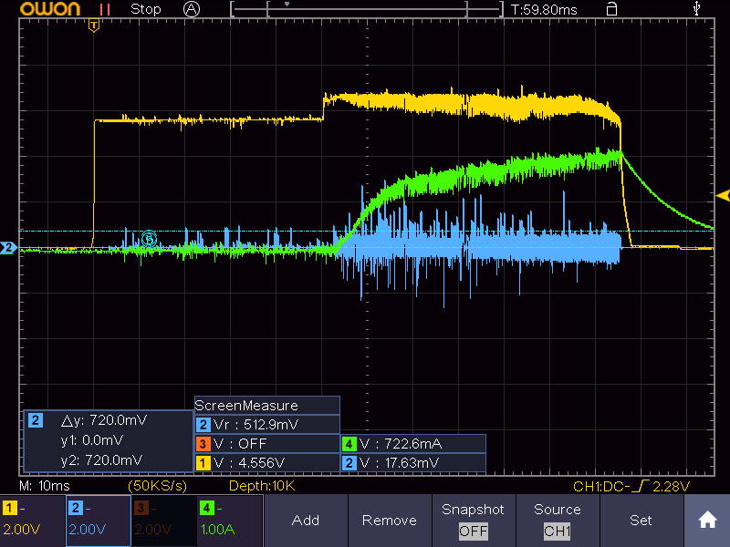

    I need help with these things too:
    1. I have problem to start with higher load. System is designed for 80V/10A but can start only with load 1,5A. After starting, it is not prolem to increase load it works well up to 7A, next system sometime switch off and restarts.
    With starting with the load higher as 2A it try start and every 1 second it restarts. Sometime it starts, sometime no. I measured all signals, problem is, I think, with ISNS setting. I used Cisns and Risns from device excel calculation. Cisns = 150pF, Risns = 90 Ohm. I try to decrease Risns too, time of starting with 2A load is longer, but not fully starts.OCP1 Ires is set to 27A, Isec to 66A.
    Here is measuring of FB (yellow) ISNS (blue), Iout (green). How to set starting with max load ?
    2. How can I minimalize small overvoltage in starting. Now it is up to 8 V over 80V. I need less overvoltage. I try change starting time, now is set to 100ms (Cllss is 1uF).
  • I think your loop response is not optimized. Please use type II or type III filter to speed up the response. It will help reduce the overshoot.
    For your 1st question, please monitor Vout as well. I suspect OVP is triggered as FB drops significantly after soft start.
    Loop optimization is a time consuming iterative process. There are articles online as well.
