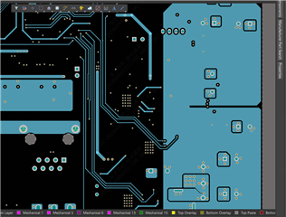

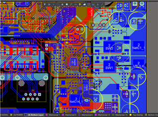

Could u help to check the PCB ,I see some ringing in driving waveform.

  • Hello George,
    Once again, thanks for being patient with this response.
    I have a few suggestions for the layout:
    • Make sure HIDRV is routed close to SW. SW is the return path for HIDRV. Make sure both of these traces are greater than 20mils in width.
    • Make sure that LODRV isn't routed directly next to HIDRV or SW. Make sure that LODRV is routed next to GND or parallel to a GND plane.
    • Make sure HIDRV, LODRV, and SW traces are greater than 20mils in width. To reduce the inductance of the traces further, I would recommend using 30mil or 40mil thick traces.
    • I would also recommend moving the VAC capacitors closer to the IC.
    Let me know if you have any questions about the layout. Also, let me know if you want me to review the layout again if any adjustments are made.
