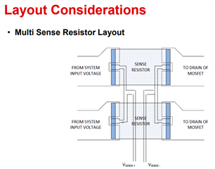

Thanks for reaching out. Please modify the current sense layout as shown below.
Please follow the below Altium file for layout.

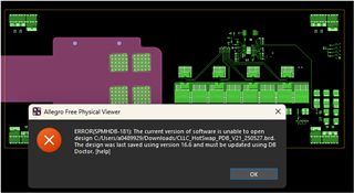

In the design, we have 4 shunt resistors.
So we connect all sense backtace together, right?
CLLC_HotSwap_PDB_V21_250527.brd
So we update a board file that connect all sense together as attacehd, please help to review it.
Thanks a lot.
Flint.
CLLC_HotSwap_PDB_V18_250519A.brd
I was able to open this one.
But not able to open this one and getting this error.
