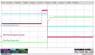

      Do you know if I need to verify OCP function on TPS23861
      Which Pin can be trigger OCP function waveform?
      Best regards
      Howard
    • Hi Howard,
      Sorry we do not have TPS23861 thermal mode. You can refer the package and thermal resistance in the datasheet.
      An OCP or Icut event will be recorded by register.
      Below is one example of OCP waveform
