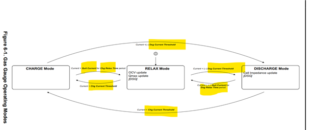

    Regarding the operation mode, can you clarify when the FETs should work automatically? In what scenarios does this occur, or do I need to send a command first?
    I've sent two commands (0x20 for DSG_FET_TOGGLE and 0x1F for CHG_FET_TOGGLE), and now the gauge is functioning as expected. Is this the correct approach?
    Additionally, do you have any ideas on how to resolve the issue with generating the golden image files?
    Thanks!
  • Hello Tarek,
    -The fets would "automatically" close when there is a load attached on the load end and when a voltage is passed on the charger end. This is based on your thresholds you've set. There is no need to send a command
    -Yes this allows the user to manually open and close the fets for research and development stage.

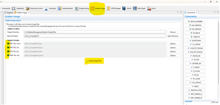

    -Please reference the picture attached below.

  • Hello alan,
    Thank you for the clarification — the operation is now clear. Could you please specify which parameter thresholds I should set to ensure the FETs close automatically in both charge and discharge modes?
    Regarding the golden image, I followed the same steps as shown in the picture, but I encountered the following error message:
    "Golden Image: Reading the data memory or flash image has failed. The golden image files could not be created."
    Could you advise on how to resolve this issue?
    Thank you again for your support.

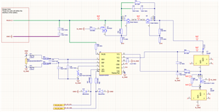

    -Can you attach your schematics to do a review on it, the battery gauge should be constantly powered from the cell. Also you attach your cell along with state your battery pack architecture.
    Thank you,
    Alan
  • Hello Alan,
    Thanks for your support.
    I’ve attached the schematic showing the BQ28Z610DRZR circuit.
    The battery pack is a 2S1P Li-ion configuration (7.4V nominal, 8.4V max, 3000mAh).
    Let me know if you need anything else.
    Extracted pages from 3_Extension Tinker V1.0.pdf

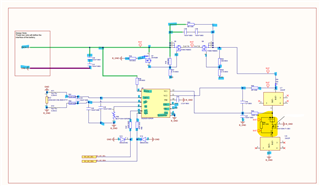

  • Hello Tarek,
    After reviewing your schematics, I was able to mark up your sheet with blue being good and yellow being of concerns. Although I couldn't the obvious reason for the gauge losing power, the best guess would be due to Q8 and R66. The fets in-between the battery pack is not needed and serves no obvious benefits and I would recommend removing the components.
    Thank you,
    Alan
  • Hello Alan,
    Thank you for your review and feedback.
    I’ve removed the FET and resistor (Q8 and R66) between the battery and the gauge, and replaced them with a direct solder bridge. Originally, the FET was added for reverse polarity protection during battery insertion, but I’ve now eliminated it to prioritize stable operation of the IC.
    However, I’m still observing the same issue — the gauge powers down every ~10 seconds.
    One more thing I’ve consistently noticed: when I connect the gauge IC via I2C and open BQStudio, the software doesn’t detect the device unless I also connect the charger. This happens even though the I2C bus driver is powered from an external source.
    Please let me know your thoughts on this behavior or if you'd recommend any further checks.

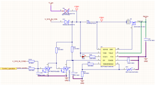

  • Hello Alan,
    Yes, I confirm that I’m still observing the same issue with the same firmware setup. When I connect the gauge IC to the EV2400 and power the I2C bus externally, BQStudio doesn’t detect the IC until the charger circuit is connected — only then does the IC power on and BQStudio detects it automatically.
    For the charger circuit, I’m using MCP73842T-840I from Microchip. I had a detailed discussion with their support team, and after several tests, we confirmed that the charger circuit is functioning correctly. I’ll share the schematics with you for reference.
    At this point, my main concern is understanding why the gauge IC isn't powering from the battery directly. I’ve measured VC1 and VC2, and the readings are within expected values.
