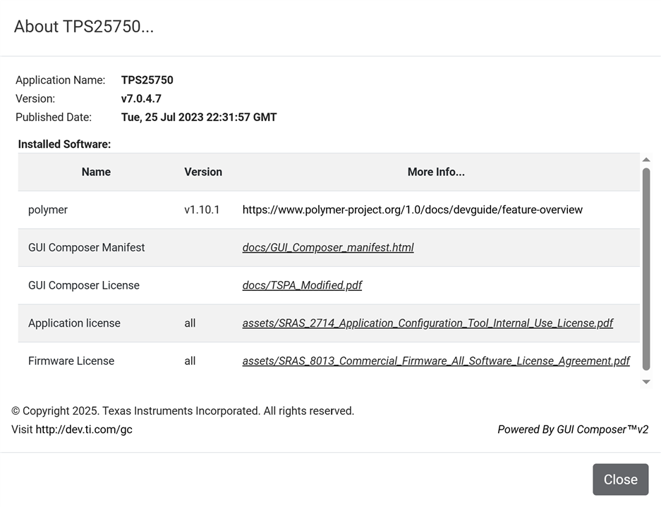

    I have been using this tool:

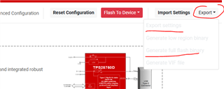

    First, I want to ask: Do I need json file or bit file to program the Flash? The tool I was using generates a bit file.
    I fill in the questionnaire and I click "Generate a Full Flash Binary" button. The tool generates a 32kB bit file, then I use Total Phase Aardwark tool to send this bit file to the Flash.
    As for 3s vs 4s selection, I don't see that selection in the config questionnaire. I checked the new one you suggest, but I don't see this cell selection there either. What am I missing?

  • Hi Iz,
    As mentioned before, the CHG-EVM was recently updated to ship with the TPS25751 IC, which is the latest version of the TPS25750. It sounds like you have two evms, one with the TPS25750 and another with the TPS25751. Unfortunately, you need a new GUI to use the TPS25751.
    The TPS25750 is not recommended for new designs, and all new designs should move to the TPS25751.
    The tool you currently have is good for the TPS25750.
    You should use v1.0.2 for the CHG-EVM with the TPS25751. That GUI can be found here: https://dev.ti.com/gallery/info/USBPD/USBCPD_Application_Customization_Tool/.

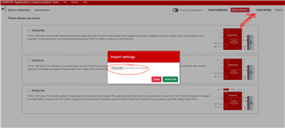

    You need the binary file to program the Flash.
    The Json allows you to save the current state of the GUI so you can reopen the GUI at a later point with the same settings. You cannot populate the GUI from a binary file.
    To load the json I shared with you into the GUI, download the json, open the GUI, and import it using the "Import Settings" button.
    If you make any changes to the gui, you can save your current progress with the "Export->Export Settings" button where it will prompt you for a file name and location for a json of the current GUI settings. The GUI questionnaire needs to be completely filled out in order to export any files.
    Correct, in the new GUI, you use "Export->Generate Full flash binary" to do the same.

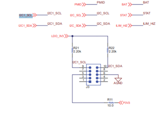

    I have 3 questions:
    1) Does TI provide the USB-PD-CHG EVM schematic in native format? Altium is preferred.  That would save me a lot of development time.
    2) Does 751 version have a different size Flash? If yes, I'm hoping it is the same footprint as 750's Flash. Just the size of the bit file is different. Yes?
    3) This is more of a statement. TI does not advertise USB-CHG-EVM with TPS25751, and it is confusing to have 2 different versions of the EVM with different size Flash ICs but  with the same name. Also not advertised is the Configuration tool version that you have specified. I wasn't aware of the version that handles 751 until you pointed out.

  • Hi Iz,
    Let me check internally. My team is not directly responsible for the board files.
    Yes and no. We currently recommend a different flash because we thought we needed a larger (512 vs 256kb) flash, but recently did some work so that the TPS25751 patch bundle fits inside the 256kb flash. So technically, no, it does not have a different flash. But, the Datasheet still currently recommends the 512kb flash (and that is what is on the updated CHG-EVM schematic) so officially we recommend the larger one. The footprint is the same.
    Correct, the update was fairly recent, and we are actively in the process for updating the document and product page with all of this information. Apologies for the confusion here.

  • Hi Iz,
    See the altium schematic file attached.
    CHG-EVM Altium Schem Files.zip
    Thanks and Regards,
    Chris
