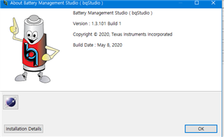

Hello!!
After performing the charge and discharge tests according to the learning procedure, I attempted to generate the golden image but it failed as shown below. What could be the issue?"
  • Hello Jimmyeong,
    Could you confirm that you are using BQstudio, updated chemID, data memory along with completing a learning cycle? Also can you confirm that it this is a EVM or custom PCB lastly that your system is using the latest firmware version and if this is a constant issue or a one time issue.
    Thank you,
    Alan
  • Hello. Alan
    I have tested by using BQStudio and the EVM.
    I have completed the ChemID update, data memory configuration, and the learning cycle according to the procedure. (I referred to document SLUA903.)
    I am also using the latest firmware.
    When generating a golden file by selecting only the SREC, it was created successfully.
    However, when selecting all file formats, an error still occurs.
    Thank you
    jinmyeong
