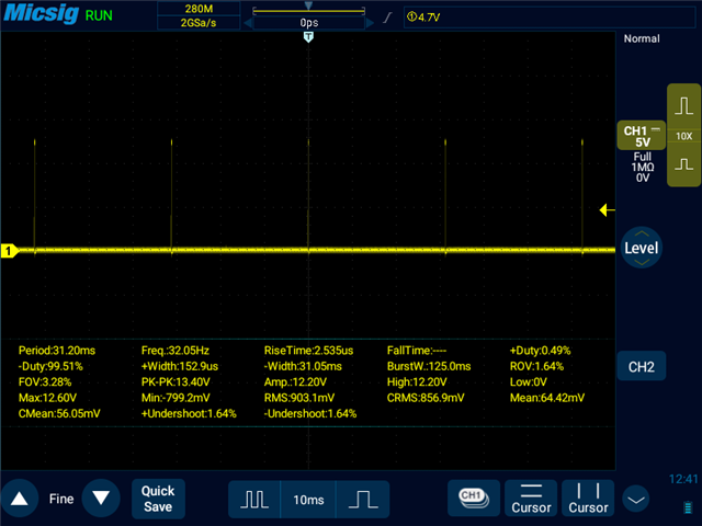

We have developed a new version of our Charger that uses larger MOSFETs than before and (as we believe) features an improved layout. Unfortunately, the new design is not functioning at all.
The problem:
The INT pin is periodically pulled low at approximately 32 Hz for short pulses.
 ChargerGUI reports no faults or errors.
 No current is flowing through the board.

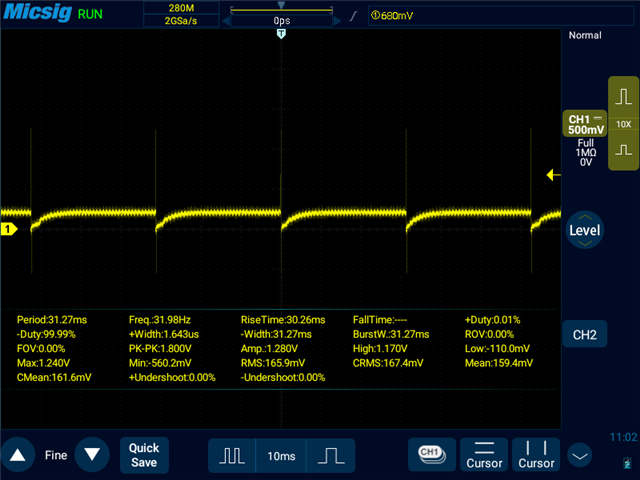

 The low-side MOSFETs appear to switch correctly: the gate voltage shows a clean digital signal with good rise and fall times and no ringing.
However, the high-side MOSFETs are not switching properly — the gate voltage rises slightly but then quickly stops. (Screenshots are attached.)

High side MOSFET gates (both show identical pattern):
High side mosfet gates

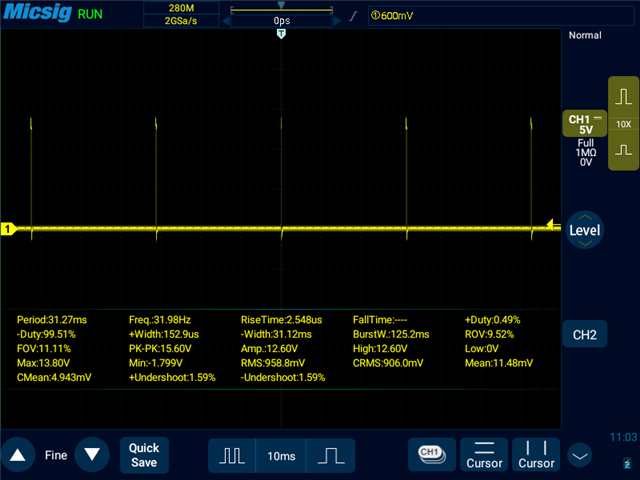

Low side MOSFET gates (both show identical pattern):
low side mosfet gate

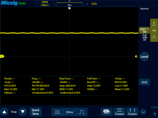

    1. Voltages on REGN, DRV_SUP, and BTST caps:
    - REGN was measured at 5 V.
    - DRV_SUP is externally supplied with a stable 12 V from a Wurth Elektronik 173951275.
    - Both BTST1 - SW1 and BTST2 - SW2 measure around 11.5 - 11.7 V, with moderate ripple (~400 - 700 mV). The bootstrap capacitors appear to charge correctly.

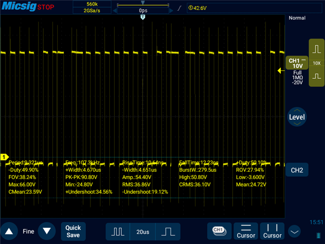

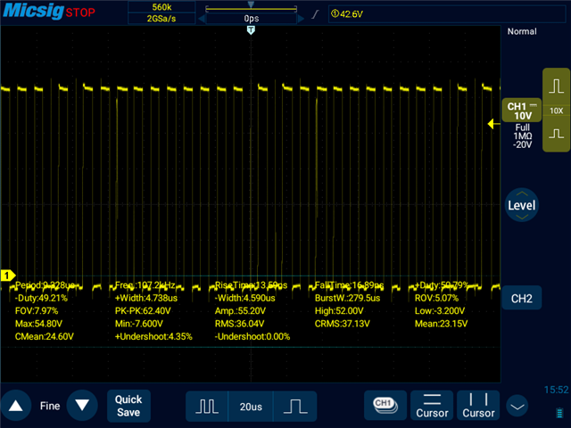

    • Can you take an oscilloscope capture of SW1, SW2, LODRV1, and HIDRV1 while the circuit is in buck mode? I want to see how SW1 and SW2 are being affected by the gate drive waveforms.
    • If possible, can you take an oscilloscope screen shot of BTST - SW? This may tell us if the BTST capacitor voltage is browning out.

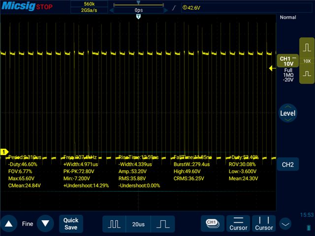

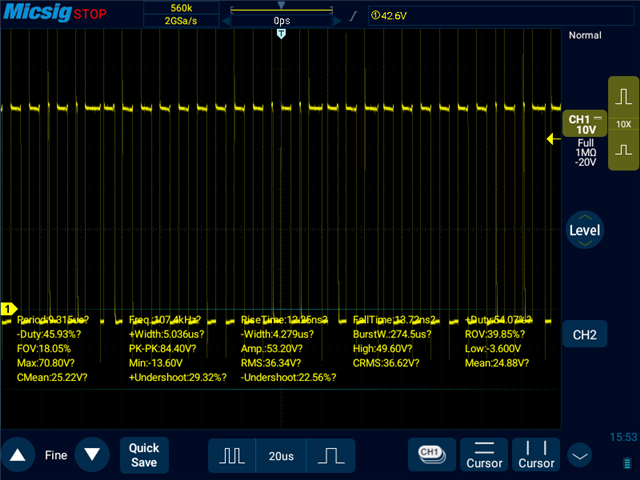

  • Hi Ethan,

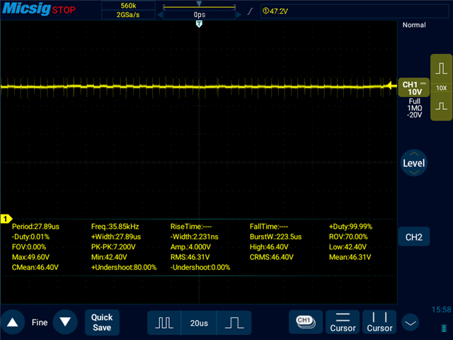

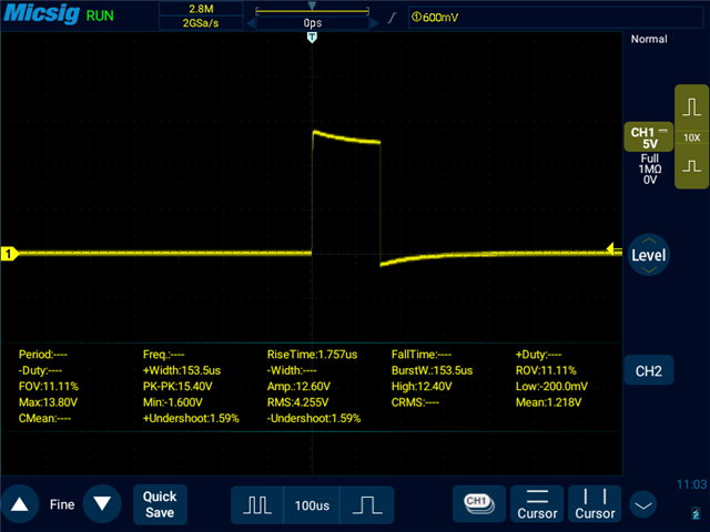

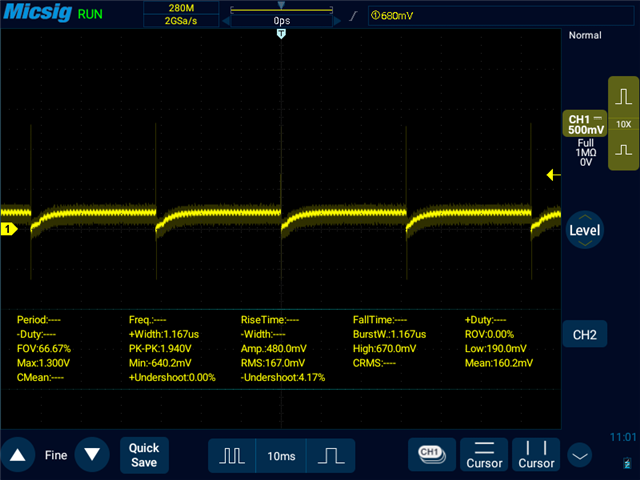

    here are my measurements, all done with the IAUT165N08S5N029.
    VAC was ~47528mV and VBAT was ~45350mV.
    SW1 - GND
    SW2 - GND
    HIDRV1 - GND
    LODRV1 - GND
    BTSTS1 - SW1
    BTST2 - SW2

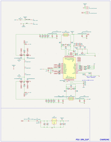

    Schematic:

  • Hello Max,
    That's strange. It looks like BTST has enough voltage to drive HIDRV, but HIDRV won't turn-on. LODRV seems capable of switching though.
    I'm curious if the circuit will work in boost mode. If you lower the input voltage below VBAT, does the circuit work then?
    On that note, if you have a 20V input to 10V battery, does the circuit charge then?

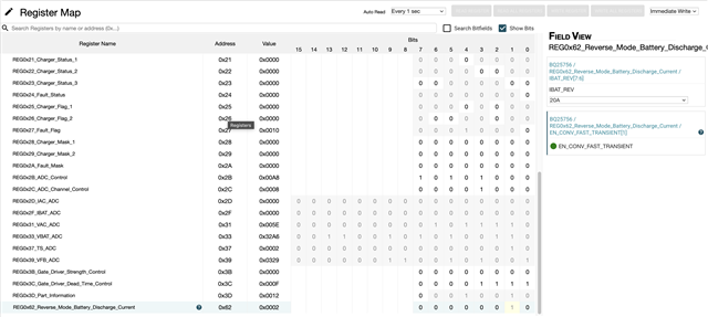

    I only found the bit EN_CONV_FAST_TRANSIENT as a readable bit:

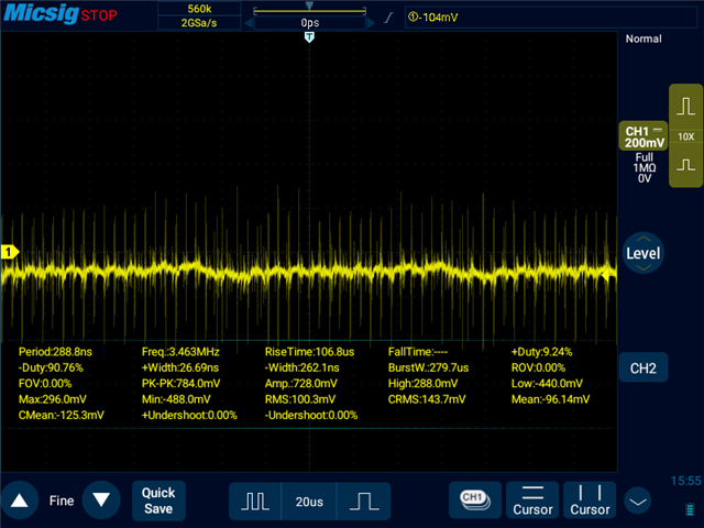

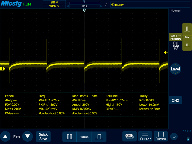

  • Hi Ethan,

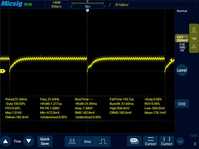

    here are the additional signals:
    SW1 - GND @ 20A
    SW1 - GND @ 10A
    SW2 - GND @ 20A
    SW2 - GND @ 10A
    IBAT (SRN - SRP) @ 20A
    IBAT (SRN - SRP) @ 10A
    VBAT @20A (measured at BAT connectors of PCB)
    Some of the instability might be caused from the battery load though. Can you tell me what you are using for the load on VBAT? I know some of my e-loads start causing instability in the output current when the e-loads reach their own current limits.

  • Hello Max,
    Thanks for the new information and the new tests.
    I am using a EA PSB 10080-60 bidirectional DC powersupply. I thought of the same problem and also testet wit a big 12S LiIon pack which showed the same fluctuations.
    Ah, thanks for the clarification.
    I see that TI charger GUI doesn't let you write to this bit. Is there any chance you have access to a microcontroller or an EV2400 to use BQSTUDIO to write to this bit?
    Also, I'll have to update the BQ25756 in TI CHARGER GUI to allow for this bit to be written. I'll try to get this done soon. At most, I should be able to get this done before the end of the month.

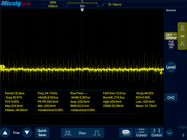

    For your oscilloscope images, I'm seeing a lot of overshoot. Just to be sure, are you connecting the ground leads of the probes to the PCB's ground? This will reduce the inductance of the GND loop and reduce the ringing on the signals.
    For the SW measurements I connected GND and SW to testloops directly connected with copper pours and close to MOSFETs.
    For shunt measurements I connected short wire stubs to the MLCC closest to the IC and between the two shunt measurement pins on each side of the IC.
    We want to control the BQ25756 with an ESP32S3 in the future and currently are writing code to do so. When we have a working state, we can try setting the bit with this.

    By the way, I started the update process for BQ25756's TI Charger GUI to allow writing to the EN_CONV_FAST_TRANSIENT bit. I'll try to let you know when this completes.
    These sound like good measurements. In that case, you may want to set the oscilloscope bandwidth filters to 20MHz or around that area. This will help clean up the oscilloscope display. Signals above 20MHz don't really affect the circuit that much.

  • Hello Max,
    The edits to the BQ25756's TI Charger GUI are complete. You should be able to use this GUI to edit the EN_CONV_FAST_TRANSIENT bit now.
    Let me know if you have any questions about this.

    Do you think the very noisy shunt measurements are messing with the current control?
    This is very possible. Can you measure the ACP and SRP pins with an oscilloscope to see how much noise is on those pins?

    What would you recommend doing to reduce the noise? Add MLCCs with smaller capacitance or higher, or both?
    This will depend on the noise frequency. I think adding a large bulk capacitor (like ≈1000µF or so) to VAC and VBAT might be a good place to start to see if a bulk capacitor will stabilize the input and output.

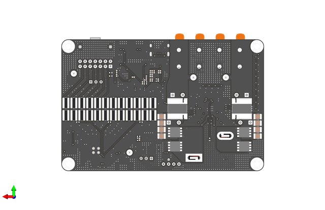

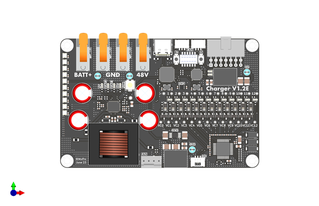

    Charger V1_1.zip
    In the meantime, here are my design files. V1_1 is what we are currently working on. Please note that we removed the SMD inductors and have now installed 3x 74437625201002 Wurth Elektronik inductors externally in series. Previously, we used only 2 of them. We increased to 3 because it allowed us to charge at 20A when we tested last week. This week, as already stated without changes to the hardware it is barely working at all. On monday I will also triple-check if we have the settings correct as we had to set them manually. Do you see any possibility how the update of the chargerGUI is causing this issue even when the settings are the same as before?

    I will measure at requested 20A the following signals - reference:
    ACP - ACN
    ACP - GND
    ACN - GND
    SRP - SRN
    SRP - GND
    SRN - GND
    If more/others would be helpfull please tell me.
    Also instructions on wether it matters what actually happenes during those measurements regarding charging current would be nice. Does it matter if the measurements are from the same actual currents flowing? It is not very reproducible and therefore might be hard to ensure same testing situations for all measurements.

    Thanks for working on this.
    I'll look over your design files next week. I'll need to get Kicad installed on my laptop.
    For your inductors, do you see any change in the charger's behavior when you use an inductor with a higher DCR?

    I recommend the following measurements:
    LODRV - GND (This signals will make sure that the FETs are being driven properly)
    HIDRV-SW
    SW1 - GND
    SW2 - GND
    BTST-SW (This will make sure HIDRV has enough power. If you see HIDRV working fine, you probably won't need to check this).
    ACP - ACN (You can also use a current probe to measure this)
    SRN-SRP (A current probe would also work here)
    ACN - GND (This will check if there's any weird spikes or dips on this signal. You only need to check this once)
    SRN - GND (This will check if there's any weird spikes or dips on this signal. You only need to check this once)
    DRV_SUP (This will make sure that DRV_SUP is enough. You only need to check this once)
    This is an understandable problem. Just let me know what the voltages and currents were when the waveforms were captured. Make sure to also note the register settings and if any register flags were set as well.
    Let me know if setting EN_CONV_FAST_TRANSIENT=0 improves the charger's behavior.

    The issue seems resolved for now. It was caused by an unfortunate series of events.
    Last time, I added a third inductor and initially thought everything was working fine at 20A. In reality, the IBAT ADC had stopped functioning and always showed 0mA, likely due to damage during hot air soldering or some other mistake (I did not notice this on that day). Since the control loop was not receiving valid current feedback, it seems to have kept pushing current blindly, which happened to be around 20A at that moment.
    We then added the third inductor to a second board and started seeing the same problems. Looking back, the root cause seems to be a combination of noisy shunt measurements and too much inductance, or possibly more EMI due to the additional inductor placed close to the board.
    After switching to a board with a working IC, using only two inductors totaling 20 uH, and setting EN_CONV_FAST_TRANSIENT=0 (which made a big difference), we were able to control everything as expected and reach the 20A target.
    At the moment, the only minor issue is that the VBAT ADC reading is consistently about 0.5 V lower than the actual VBAT. Do you know whether the device uses the shunt pins or the FB pins for measuring VBAT ADC? Since the offset remains even when charging is disabled, I doubt it is caused by switching noise. If it is measured at the FB pins, the offset could be due to the resistor tolerances in the divider (I used 1% resistors).
    Unless you specifically need it, I would prefer to skip capturing oscilloscope data for now and save the time.
    I'm not seeing any obvious issues in the layout, though. In fact, the layout looks really well done.
    Do you think the shunt noise could be significantly reduced by changing the layout and using much shorter traces between the shunts and the IC? The downside would be that more of the high-current and high-temperature parts and traces would end up closer to the IC.My hope is, that with cleaner shunt measurements we can reduce the need for C and L.
    I am thinking about something like this:
    I guess it's hard to say for sure, but I would appreciate your gut feeling on this.

    It sounds like the SRN / SRP pins got damaged on this IC.
    Let me think about this and get back to you. My gut feeling would be to not adjust the board if it's working. I think the decision to redo the layout would depend on your other systems needs. For example, do you need to adjust the cost by using smaller inductors or capacitors? Or, does the system need a smaller battery charging board?
    Also, you might be able to test how much capacitance is needed on the current board by slowing removing capacitance. This way, you can save on the cost of capacitors without having to do another board layout.
