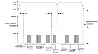

I wanted to understand the behavior of watchdog feature. In my application I am pulling down WDI pin.
My question is, when we pull down WDI and if there is no rising edge at WDI pin then is this chip is in watchdog disable mode and only reset based on voltage?
As per below figure it is showed that till rising edge at WDI, output of chip is not asserted (reset is 1).
Nilesh
  • Hi Nilesh,
    According to datasheet, first WDI positive edge affects only lower boundary. Please find timing rules in below.
    If you miss providing the positive edge before the watchdog timer ends, this will assert the RESET.
    Depending on how you configure the WDT pin, you can either have 0.25 second or 2.5 second window timeout.
    Hope this answer your question.
    Sila

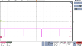

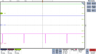

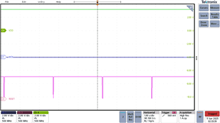

    As the datasheet highlighted, our some of supervisor can create internal WDI signal. And TPS3813 is not one of them. Please find the bench data I got for you in below.
    WDI is not connected (left floating):
    WDI is connected to VDD:
    WDI is connected GND:
    Result: In all conditions, device is asserting due to WDI input signal is not applied on time.
