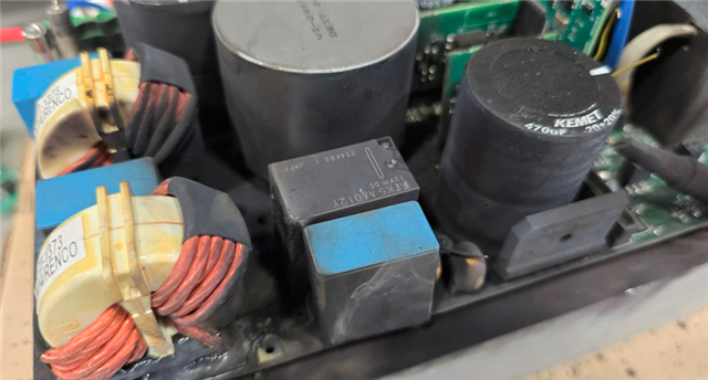

While testing the PCB with my colleague Sebastián (who has posted a few posts on this forum), a large explosion occurred on the board and a subsequent fire broke out.
The board was working fine before with some problems on the control loop parameters, so we could discard a big problem with the PCBA assembly. Here the pics of the board fired.
The explosion started in the PTCs (R160 and R165), and then the rest of the board caught fire.

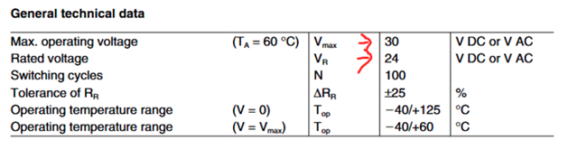

Analyzing these components, we see that they are 24V DC/AC and a maximum of 30V DC/AC, when these components are actually connected to the 230VAC input. Therefore, it's quite understandable that this component exploded. Here a screenshot of PTC  (B59101P1080A062) in the schematic and datasheet of the part number :
A design error seems obvious. Does Texas Instruments have any explanation for this incident?

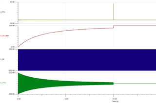

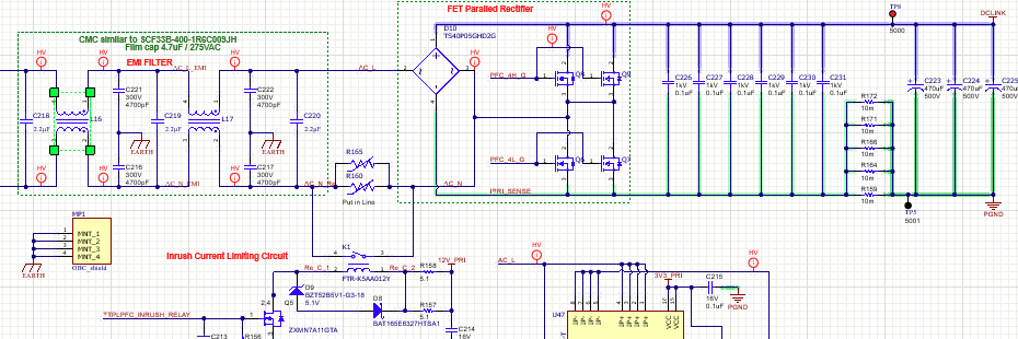

    The PTC is acting because, in a transient state, when the board is initially connected, the DCLINK capacitors (C223, C224, and C225) act like a short circuit (low inpedance). The chokes (L16 and L17) also have very low impedance, so almost all input voltage falls across the PTCs until the relay is activated. Here schematic:
    I have done a simulation with TINA and it confirms what I am saying:
    As you can see in the simulation, until the Relay is activated, in the PTC there is a lot of voltage, more than 24V recommended by the manufacturer. So probably this is the cause of the fire.

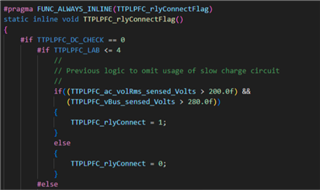

    3. The relay was probably not activated, since our firmware didn't activate the relay until the TTPLPFC_VAC voltage was above 200VAC.
    This is how our FW was when the board exploded.

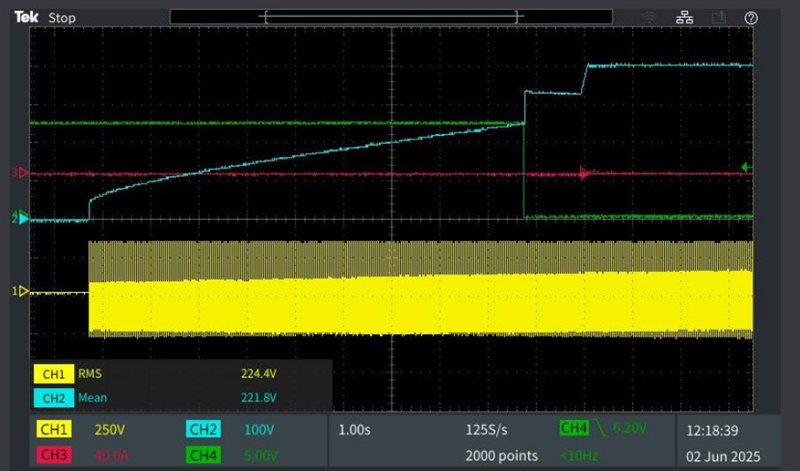

    I'm attaching a screenshot of the osciloscope before the explosion:
    As you can see, the signal on CH1 is the input voltage (230 VAC).
    The signal on CH2 is the voltage on the DCLINK that is charging without any load on the DCLINK. If there had been a load, this signal would not be ramping up.
    The signal on CH3 is the input current. As you can see, it is very low, with only current spikes of a few mS during charging of the capacitors.
    The signal on CH4 corresponds to the relay activation. When this signal drops to a low level, the relay is activated.
    It is clearly seen that during the charging of the DCLINK capacitors for a few seconds the voltage on the PTCs is much higher than 24VAC and this clearly damages these components.This is confirmed by both the simulations carried out in Tina Space and the oscilloscope captures.
    Please tell us what happens to your board when it's powered by 230V and the relay doesn't activate until the DCLINK capacitors are charged (no load on the DC LINK). Can you please run this test for us please?
    Note that previously in the experiments we performed earlier, the relay was activated instantly when the board was connected to 230 VAC and this triggered the magnetothermal and differential switches due to high current peaks, this is why the tests we performed involved delaying the relay activation to gently charge the capacitors through the PTCs but doing these tests the board exploded.
