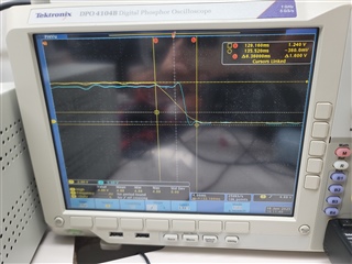

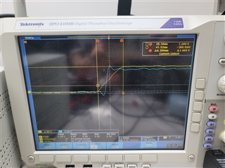

  • Dear Rishika,
    Thank you for your support.
    I measured EN and OUT in case of rising and falling of EN pin, but the time gap of EN and OUT is very short.
    So I think it is not a problem of turn on and turn off especially this low frequency and duty cycle.
    (EN pin is rising, yellow is EN pin, blue is output.)
    (EN pin is falling, yellow is EN pin, blue is output.)

  • Hi Chase,
    The waveforms look fine for turn on and turn off, but it does seem like there is slight oscillation on the curves. Although doing an experiment can provide a good idea of the typical turn on or turn off time, it is better to calculate the worst-case scenario including the maximum delay times.
    For resistive loads, we recommend using purely resistive loads like a power resistor/box. We do not recommend using e-loads in constant current mode because they cause issues with our high-sides switches since it is trying to draw a pre-set current at all times (detailed explanation at the link below). If an e-load needs to be used, please be sure to use it in constant resistance mode.
    (+) [FAQ] Why does my e-load cause my high side switch to shut down? - Power management forum - Power management - TI E2E support forums
    For the data you provided before - did you calculate this or did you do the experiment and see these values? PWMing does not change the output current or voltage unless you do not give the device enough time to fully turn on or turn off. So, in an ideal situation when the device is on, the output voltage will be the same as the input voltage and the current will be as expected based on the load. The data you provided does not follow this concept.
