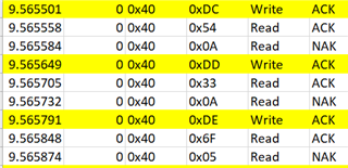

my customer use below SCH find E1h report doesn't match expectation.

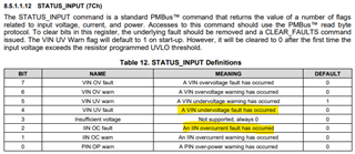

Register of E1h.
we also crosscheck the register of 7C. it also show VIN_UV and IIN_OC.
But over all SCH is operate normal and UVLO/EN pin voltage is around 1.23V is also higher than threshold.

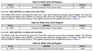

below is DC/DD/DEh register value.
do you think it's normal for you ?
