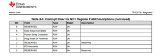

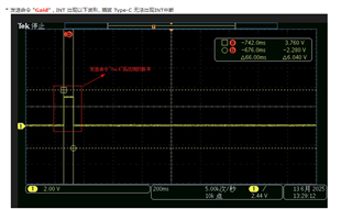

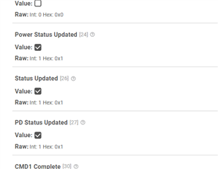

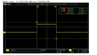

Hello Chris:
I have generated a new BIN file to enable the interrupt. But based on our test, the interrupt only happened on the first plug, but no more interrupt when re-plugged. The JSON file is attached here, and I believe "Power Status Updated", "Status Updated", and "PD Status Updated" are all checked in the Interrupt Mask for I2C1. Could you help to check and advise?
Thank you!
