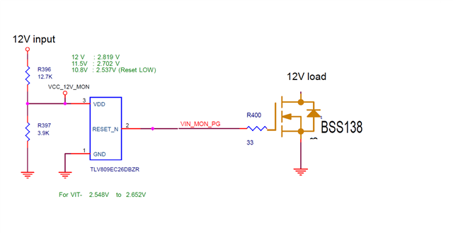

HI All, I have simple circuit, with (High & low) issue.
I am using TLV809E (2.6V) to monitor the voltage
If Voltage at 12V, i should get high to trigger the N-Mosfet
If voltage below 10V, then i should get low.
But in my case, i am always getting low from TLV809E.
If device isolated from MOSFET, it works fine. When i connect to FET, its always driven low.
What's really goes wrong on this?

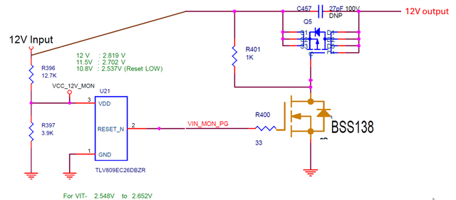

  • By removing R400, TLV809E isolated from load.
    Then we are receiving proper response from TLV chip
    1. high (2.8V at 12V)
    2. Low (below 2.54V)
    > if we populate R400, then TLV809E chip always in 0V position.

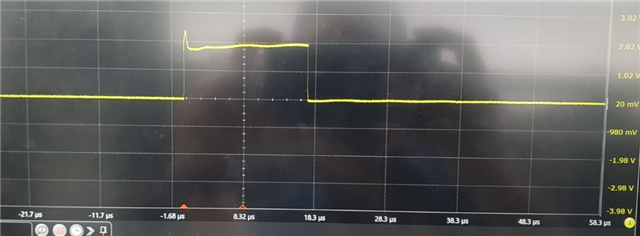

    > few times we are observing pulsed output  like below image.
    Probing U21.2 pin.
    NMOS and TLV809E, both separately working fine by removing R400.
    While we connect TLV with load, then observing always low, even at constant 12V.
  • Hi Shiyamsundar,
    It seems that the input is lacking enough charge to power the entire system. By adding a bypass capacitor of 1µF should ensure that there is enough charge. Please note that by adding a bypass capacitor, it will add a delay in how quickly a change in the 12V rail will be reflected on the VDD pin. If the 1µF is not enough, try increasing the capacitance.
